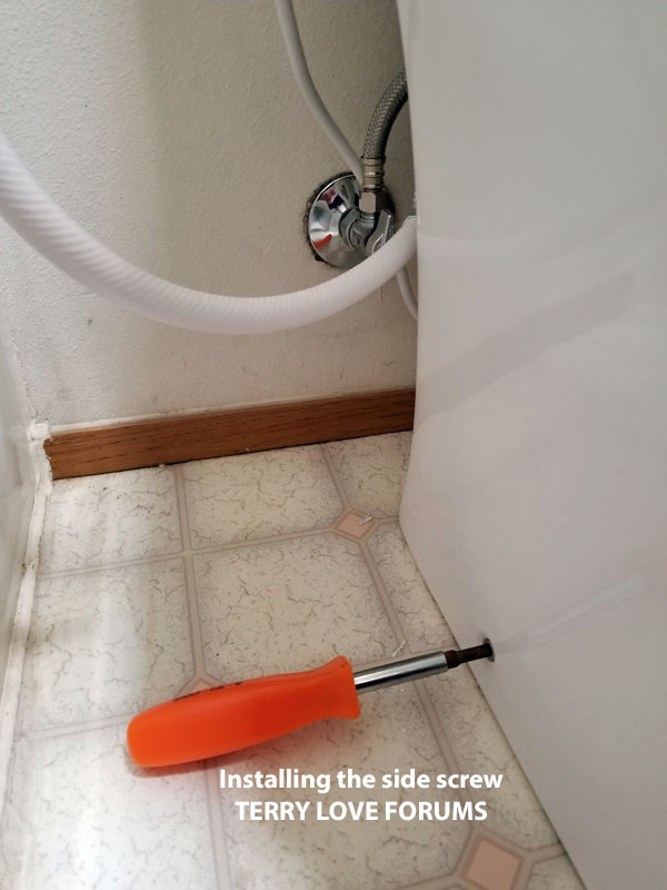

Installation is done with the standard TSU08W.12 12" Unifit here for the Aquia. The shutoff was replaced with a new 1/4 turn valve. The mounting blocks are also screwed to the floor. The the bowl gets dropped down over this.
This one is getting a Washet,
The mounting screws go in from the side to the mounting blocks inside. I like to drill a hole in the side to make it easier to put the screw in.
Without the Washlet, I use a 16" toilet supply from the tank, but since we are installing the Washlet I need the THU9090R to add some length for the Washlet supply tee.
