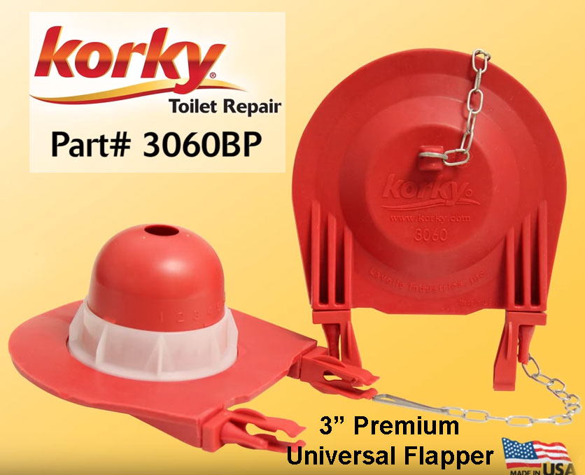

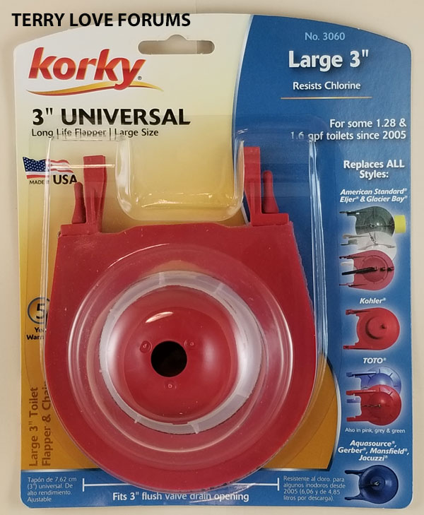

If the water stops at the mouth of the flush valve, and the rim of the seat is smooth, and you don't want to wait for Toto to send you something, then I would just go get the Korky 3060BP (3060PK at Lowe's, 3060CM at HD) adjustable 3" flapper at Lowe's, where it's cheaper than HD and they carry a broader selection of Korky products. (They make a 2" adjustable flapper, which actually has a float, and which you don't want: you need the 3", which adjusts by covering or uncovering holes in the flapper.) I'm guessing a decent starting setting would be 5, but follow the instructions to tweak it. I don't think anyone on here recommends the Fluidmaster 3" adjustable flapper; get the Korky, since they make OEM parts for Toto.

In your opinion, is the Korky flapper better than the OEM one?

We haven't talked much on here about replacing the 1.28gpf flapper with a Korky product, but they are universally-admired for the Toto 1.6gpf toilets (indeed, they are Toto factory-authorized replacement parts) and they are admired as replacement parts for other brands. If Terry's suggestion as to the seating of the flapper doesn't work -- it often does work -- then I would just spend the $11 for the Korky adjustable and be done with it. You will eventually need a new flapper, so I would take Toto up on their offer and stick it in the drawer for when you need it. If it failed within 2 weeks, it's fair for them to replace it, and it isn't worth $21 for the THU331S flapper if you can get the Korky for $11 at Lowe's.
