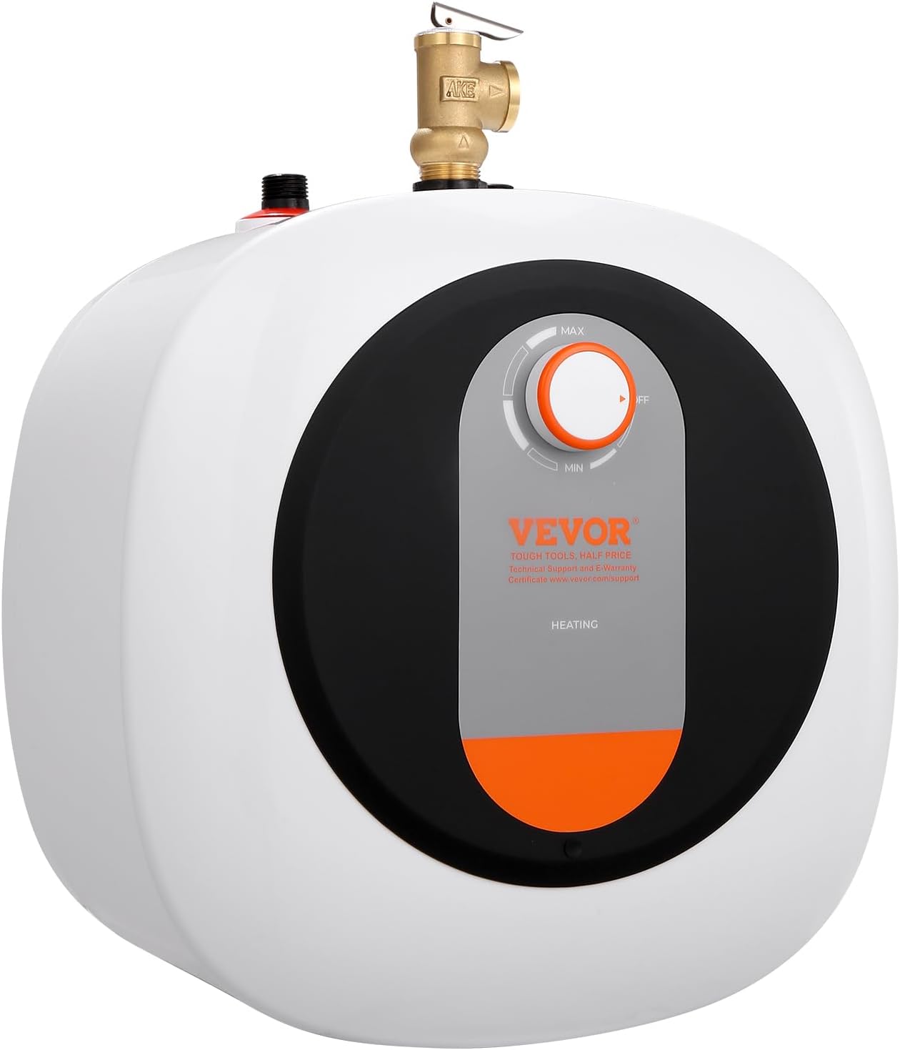

I put in an Amazon Chinese Vevor 4 gallon water heater that feeds two bathroom sinks in a small commercial building I will be selling (just toilets and sinks, no baths or showers). It had no hot water at all after a boiler replacement and I used this 4 gallon wall hanging POS because it was cheap and it took up virtually no room in the 8'X8' boiler room, plus I didn't have to run any more electrical wires or add a breaker to the panel.
The good - it works perfectly. I had a dedicated 15A outlet that only fed the boiler room and 1 bathroom, but there's nothing plugged into either socket. It pulls 12A during heating and never tripped the breaker. 4 gallons is enough to feed both sinks for hand washing.
The bad - the projected life is like 8 years, and I would be surprised if it lives that long. It does supposedly have an internal sacrificial anode rod, but I won't have the building by April so I don't care.
