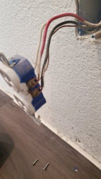

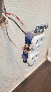

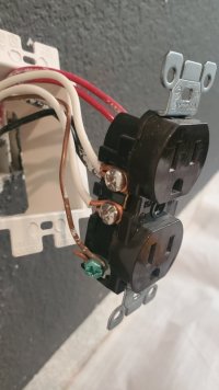

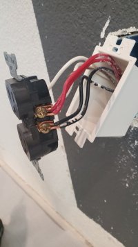

Hello everyone!
Need some help with a wiring project. In our living room, we have two duplex outlets along the same wall (both are single-gang boxes). The top outlets on both receptacles are controlled by a wall switch (see poorly drawn diagram :)). I would like to add two (hardwired) wall sconces on that same wall (one above each outlet) that I could ultimately control by the wall switch. I would prefer that the top outlets are no longer controlled by the wall switch (same as bottom), so that only the wall sconces are linked to the wall switch. Given our current configuration, what would be the best and easiest way to accomplish this? I believe the existing wiring is 14-gauge. By adding the wall sconces, would I also need to replace the current single-gang boxes with larger capacity ones? Thanks in advance for all forthcoming replies. Martina

Replace the two reciprocal just wire them with bottom two wires. Fish wires down to the reciprocal might need deeper boxes.

First you'll need to replace the outlets since the tab to splits the outlet has been removed. To add a jumper wire you already have to many wires at 12 gauge.
All you need to do is take the red wire to the wall sconces for switched power and the neutral and ground. The first box will get crowded and changing it out as you plan is good.
For continuous power for the outlets, wire in as it already is But with new outlets. At the first outlet use both gold color screws for the black wires, power in and power out to the next outlet. For the white, I would pig tail it. All three whites wired nut together with one wire to the white color screw.

These outlets were not installed by an electrician. The wires do look like 14 gauge, not 12. An electrician would not double up on one screw terminal.

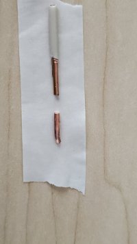

Regarding the wiring- I just checked the breaker again and it says 20A. I turned it off to verify and actually clipped off a piece of the wiring to compare with a 12/2 roll I have on hand. It seems as though they're matching (see attached image # 2). I'll take it to the store later to compare it with a 14-gauge to make sure.
