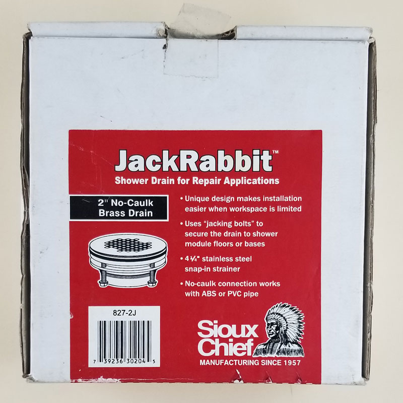

Sometimes I will get a call about a leak showing up in a ceiling below a bathroom. What I find when checking with a moisture meter may be that it's right under the shower drain. Sometimes those drains were installed with plumbers putty, and over time it' loosens up, especially with people in the shower walking back and forth in the shower. One drain I like is the Sioux Chief JackRabbit with allows me to tighten up with a screwdriver. You don't always have access to thread on a nut using pliers after the shower base has been installed, so this is a God Send for a plumber.

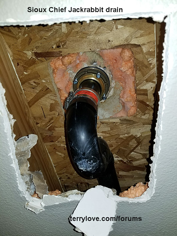

A shielded coupling as part of the repair to prevent pipe shifting. You can see the screws that allow tightening. The white on the bottom of the p-trap was from where it had been leaking before. Now it's time for a ceiling repair. I'll let the Wall Doctor handle that one.
