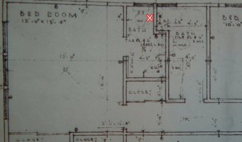

Meantime i'm in midst of a way more complex issue, cuz my shower-pipe & shower-arm wobbles. See, due to my 50's home, i don't have standard studs/drop-ears securing the shower-arm. Instead the wood-beam is internally to the left of the showerArm hole. Yes, there's expanding-foam, but that would not be secure. So what do you think of slicing a rectangle out of the old-fashioned wallpaper that's on barely-used bathroom on reverse side of my bathtub?
My attached pics explain it all. What should be the approx. cost for fashioning a hinged access-door via the other bathroom, and securing the shower-pipe with a bracket, as well as to re-tile the square surrounding the tub-spout+trim near the tub?

On a side note rather than create a tile job if you are cracking open the other side of the wall to fix shower head strapping couda just done the work from that side?
