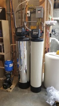

So I hade the unfortunate experience of a whole house resin blow out. Still can't really figure what caused it or was it going on for a long time (after the clean out I removed about what seemed like 2 buckets of resin in the hot water heater alone, not to mention what came out of the pipes.)
so a few things in this post I hope someone can address.
Curious, I took apart the resin tank and while the baskets seemed brittle, its hard for me to believe that that much resin got past them that fast, they don't seem to have any huge holes, but then again I noticed some imprints of where the basket could have been crushed? Also I have no idea how much pressure is in there to begin with!
MAIN CONCERN: I want to be certain that there is not SOME other softner part that could have failed that I am not aware of? (like in the actual valve I have a WS1) I certainly don't want to go through all the trouble of rebidding this thing, with new distribution tube and baskets and resin only to have it happen again, because I forgot to check for XYZ.! (I will for sure use the conservative method of filling tank to a avoid resin blow out)
> do I need to clean out the clack valve? (aside fro the injector) if so how do I do that?
EXTRA: if anyone has insight on what could have initiated the cause let me know, coincidently we shut water off to the water heater (Only) to service the anode rod, and after we turned water back on that is when we go our first clog in the pipes, then every fixture was clogged! (note we did not remember to put water softener in bypass or anything like that while we did the work.. oops... (note the RO filter was not turned off either and that is on the cold water line.
Is there some other pressure issue I should be looking at ?

Classic result of the system being equipped with a low quality bottom basket. The bottom basket is the only component that prevents resin from escaping into your plumbing system, so best not to cheap-out there.
Recommend replacing with either a Clack or Fleck basket and riser which will be high quality and less prone to failure. Many water systems obtained from online sources, are equipped with cheap, low quality baskets so as to lower the expense for that online dealer.
As you didn't mention bedding gravel, I expect none was installed. Gravel is also commonly excluded in online systems as the additional gravel weight increases the dealer's shipping expense. After excluding gravel, some dealers will then equip the system with a shorter than standard height tank, which then further lowers the dealer's expense for both the tank and shipping.
Bedding gravel provides several benefits including burying the bottom screen as the gravel is to fill the tank's bottom dome. The larger, heavier gravel then will keep the smaller, lighter resin granules elevated above and away from the bottom basket. This will permit more resin to be utilized to remove hardness, and also reduces the potential for resin loss in the event the bottom basket becomes compromised.

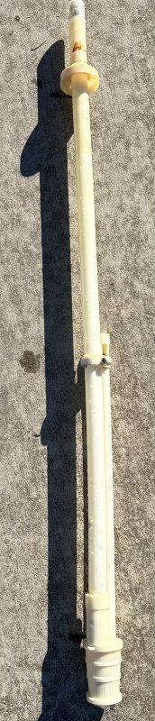

thank you for that info.. I would be very surprised at this MFG skimping on parts. the part I have is called Turbulator made by Nelson corp. seems like a patented design no one else uses: https://www.nelsencorp.com/itemdetail/TURB-1044-1050 Nelson Corp also..
"Turbulators help water softeners last longer by distributing the brine solution to the upper portion of the media bed for a much better cleaning compared to a standard distributor tube. They help softeners remove more hardness, iron and manganese. They increase your water softener’s efficiency by up to 80%. Turbulators do not require a gravel under bed.
Turbulator Assembly For 44" Water Softener Tanks quantity"
I will look into bedding with some gravel too, can you please advise on that, how much I need for a 1cu ft tank. and then I assume I would still put in the whole amount of 1cu ft resin... (although it says with the use of the turbulator no gravel is needed)

True that gravel under bedding cannot be utilized with softener equipped with a turbulator. A turbulator functions similar to a pump, causing the most depleted resin located at the bottom of the tank to be circulated (reclassified) to the top of the tank while backwash is occuring. While reclassification will also occur during backwash without a turbulator, reclassification will occur more slowly, so the Backwash setting will typically be programmed for at least 10-minutes duration.
A turbulator is only occasionally utilized for well water which contains some amount of ferrous iron. Since removal of ferrous iron with a softener is not an efficient method (1 ppm iron will consume the same hardness capacity as removing 85 ppm (5 grains per gallon) actual hardness, generally recommended to utilize an alternate iron reduction method prior to a softener, especially when the iron amount exceeds ~ 1 ppm. The 1 ppm iron recommendation limit is intended to only eliminate the additional expense for a dedicated iron reduction system because the iron quantity is relatively low, but even with such a low quality of iron, a dedicated reduction system would be best and more efficient in terms of salt use and the elimination of the additional ongoing expense and maintenance needed to remove iron accumulation from the resin.
Even while equipped with a turbulator, soft water flow through the resin to the home plumbing continues to be downward through the resin, so the softened water will exit the tank through the bottom screen, up through the riser tube, and directly out to your home's plumbing system.
Your photo shows at least one slot on your current bottom basket screen where the screen appears to be deformed, resulting in a wider gap, which is likely wide enough to permit resin to pass through. If your system is equipped with 'Fine Mesh' resin which is occasionally utilized (but not generally recommended) for reduction of ferrous iron from well water, any distortion of the bottom screen will be more prone to permit a greater amount of the even smaller resin granules to pass through. Fine Mesh is not generally recommended as it will compact more tightly, thereby resulting in greater flow restriction through the resin bed. Many users complain of low pressure during water use when Fine Mesh is utilized.
You asked about pressure within the tank. The pressure will be equal to the incoming pressure provided by your well pump or municipal water supplier, and the flow rate while supplying soft water to fixtures, will equal the flow rate flowing to fixtures.
You also mentioned replacement of your water heater anode. As the water heater was likely drained somewhat, if you quickly reopened the supply valve to the WH after repairs were concluded, the flow rate through the softener will have been extremely rapid and sudden, which would place additional stress on the bottom screen, compared to what is usually experienced under normal soft water use.

You need to just go get a new clack unit with the #10 resin in the unit....
dont fool with trying to resurrect that older unit.........
Odds are that their is a good chance the resin just blew up and expanded due to the chlorine in the water
we get this happening all the time with the cheap ass #8 resin...........
In the Clack units I install , I put a small screen installed into the out going side of the bypass
that stops the resin from ever getting into the system...... the resin will just stop at this point and
someone will have to put the unit on bypass to get water flowing through the system again but it saves everyone
a ton of misery and work
The part looks like a sowing thimble tha tonly allows
the water to pass through.... You should get one of those for your bypass.. for 5 bucks..
I call BS on the content of that quote. Turbulators do affect the backwash, but not brine solution distribution.
I suspect your failed Turbulator is not the original Autotrol brand, but is some looks-like knockoff. I don't know that, however.
One thing to check is that the softened water comes out of the pipe on the left, when viewed from in front of the display. Sometimes things get piped backwards.
A cartridge filter on the output of the softener would have caught these pieces. A 5 micron filter can also catch smaller stuff that comes in from your city water or well water.
1. On the beads that you found in your aerators, are they nice round beads, or are they broken, as occurs with chlorine+time damage? You would probably need magnification to see that.
If they are broken, that could have contributed a lot to letting pieces slip thru the slots.

I guess I can sell you what you might need and just mail them to you but you
would need to post a picture of your system and the connections on the back
side so I can see what connections you would need....
its a pretty simple no-brainer kind of fix

I had a similar problem when I replaced the media in my softener. It is an Aqua Pure NWS 100 system from about 2008. It has that same tube in it, there is a float assembly on the smaller tube. The softener had gravel in the bottom of the resin tank. I cleaned the gravel and reinstalled it in the tank and then added 1cu.ft of the Aldex 10% media. I refilled the tank at did a purge on it. It promptly dumped the media into the house water supply, clogging numerous faucets. I ran about 200 gallons through a garden hose and it never cleared up. I am thinking the float ball in the smaller tube is causing the problem. The lower part of the turbulater appears to be in good condition. The float valve sits in the media and does not have a screen around it. This matches the schematic of the components from the parts list I had.
Here is a picture of the turbulator assembly. Should this be replaced with a standard Fleck style tube and intake screen?
While alternate methods for iron reduction are usually recommended, a Turbulator is occaisionally utilized when the raw well water contains a considerable quantity of ferrous iron. When a turbulator is installed, no gravel is normally utilized in the media tank.
Don't know what is meant by 'did a purge'.
The short writeup linked below, details the recommended proceedure when installing a new softener, or when reactivating an existing softener equipped with new resin.
Softener Startup Proceedure
I would recommend that.
A new riser tube equipped with a new bottom basket, will typically be supplied longer than needed, so the riser tube will need to be inserted within the empty tank, to identify where to cut the tube, which is usually even with the top of the tank opening.
Edit to add: It promptly dumped the media into the house water supply, clogging numerous faucets.
Suggest verifying your softener's control valve Inlet and Outlet connections are not reversed.
When a softener is supplying soft water to the home (Service Flow), it is designed for hard water to enter the media tank above the resin bed, then flowing downward through the resin, thereby allowing hardness ions to be removed within a tightly compacted resin bed. Once the softened water arrives at the bottom of the tank, flow then continues through the gravel and bottom screen, then upward through the riser tube, exiting through the control valve's outlet port to supply downstream fixtures.
If the softener's inlet and outlet connections are reversed, then hard water will enter in reverse, downward through the riser tube to the bottom of the tank, thereby resulting in upward water flow which will loosen and lift the resin. During occaisions of particularly high service flow such as when first restoring flow after replacing the resin, the resin may become lifted to the top of the media tank whereby it can be pushed out into the home's plumbing system, particulrly when no upper basket is installed directly below the control valve.
