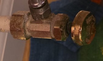

I need to replace some water shut off valves throughout the house as they have minor drips. It's been suggested that at this point, while I'm replacing some, I should do them all. The house has 3 finished levels and is 24 years old.
I know I need to turn off the main water and then open all faucets, etc to drain all the water before I remove any valves.
Here come my stupid questions.
1) how do i know all water has been drained? I assume just that it's stopped in all open valves.
2) my bigger question is do I need to drain the gas hot water heater? Or will running all the faucets effectively do that? The water heater is 50 gallons.
Any other tips or tricks.
Thanks.

They are not Accor. I think they're just called inlet compression valves. This is what most look like.
The symptom on a good number of them is a slight drip. Sometimes, with a little playing around, I can get it right so it doesn't drip. But they get so touchy.
I've read and been told that since the house is 24 years old, even if some aren't yet dripping, once I've got the water drained, I might as well replace them all.
Yeah, I guess I'm just used to talking switches and trying to make sure I don't have water damage doing this.
The water heater is in the basement. Also in the basement are at least 4-5 valves (2 sinks and a tub/shower, plus one valve to the humidifier and one to the hot water heater).
To me, it looks like all the valves are compression valves on the PVC. I can't recall any copper.
I think they are all 1/2" PVC.
Any suggestions on what to replace them with? Same, or the quarter turn valve?
Thanks.
It may be CPVC, which is 5/8 (0.625) inch OD -- same as copper. 1/2 inch PVC would be 0.840 OD.
You may be able to replace most of the valve, but keep the old nut and ferrule (olive) in place. You could start with a pipe that has enough length to support cutting the pipe some to allow a new valve.
SharkBite push-on valve have their advantages. They can go on 1/2 inch CPVC. There are also cement-on for CPVC. https://www.supplyhouse.com/Dahl-61...omp-Angle-Supply-Stop-Lead-Free-Chrome-Plated for example.
