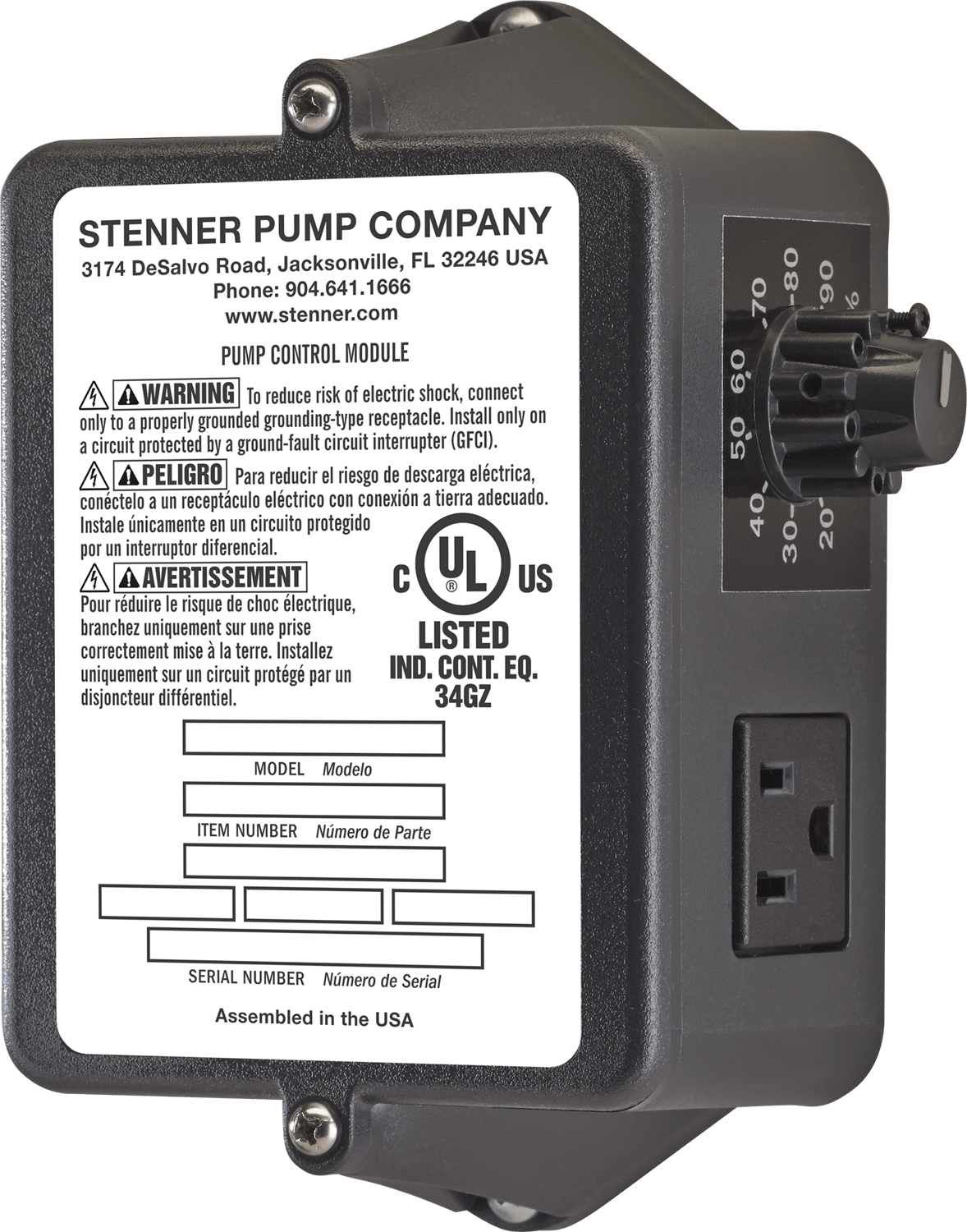

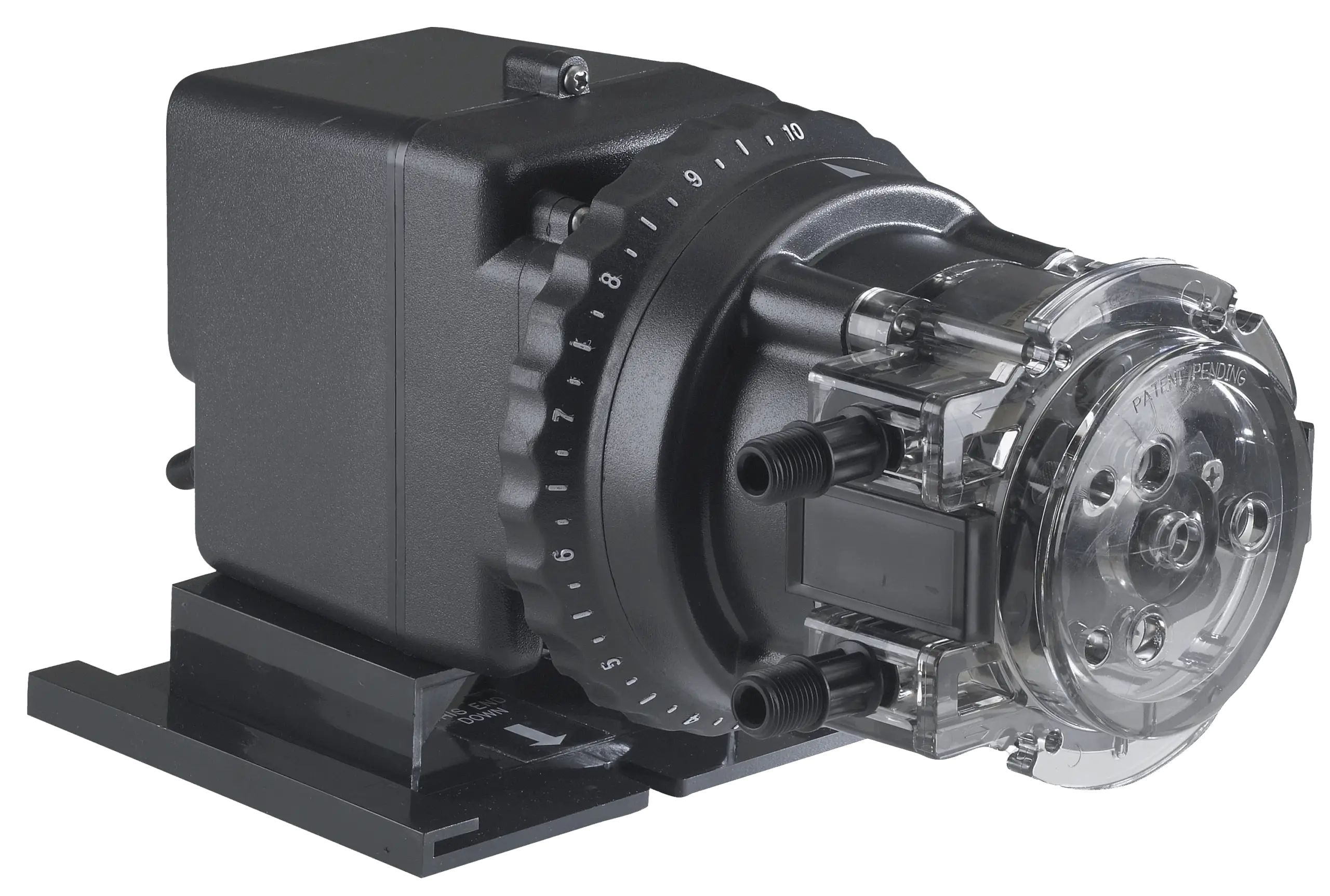

Chlorine is injected from a stenner pump at the inlet before the 120gallon holding tank. There is a flow switch that turns the pump on whenever water is running in the home, switch is located after the holding tank. Stenner pump only runs at one rate no matter how much water is actually being used.
The only way to change the injection rate is on the physical chlorine pump, which has a dial from 1-12. Currently set to 12 for max injection per prior owner.
An injector after the pressure tank and a flow sensor downstream of the presure tank would usually call for a proportional sensor for use with a proportional pump.
What Stenner model?

Stenner pump is model 85MHP17. Correction from prior post, dial is 1-10.

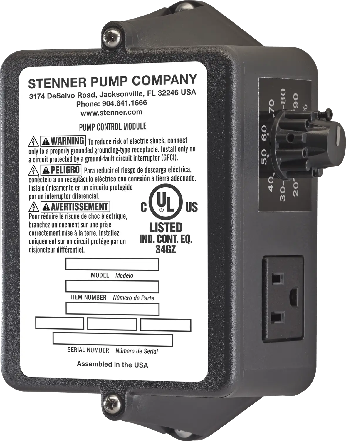

It appears you put this in line with the power to make it proportional:
has diagram.
Do you understand why the pump system should be proportional if injecting downstream of the pressure tank?
Ravens135
25
NY
has diagram.
Interesting. Yes, I always thought it was inaccurate to have the same injection amount whether I'm running a trickle of water out of the sink or if I'm running full water flow out of a bathtub. Obviously that is going to change the ratio in the holding tank quite significantly.
