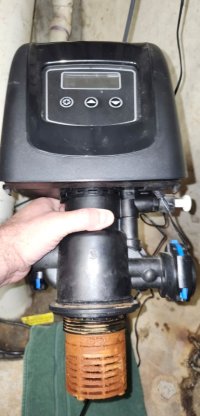

I'm finally getting around to putting my iron filter back into service, as you can see, the rust build up from when I took it apart. Couple questions:
1. Are these spacers and such required ? Fleck 5800sxt
2. Been reading a lot on the top of the riser tube should have an umbrella type diffuser. Does that replace this stack?
3. Just going to replace with same riser tube since it came out ok. Or should I replace it with one with umbrella top?
4. Best way to clean this bypass valve? Soak it with Iron Out?
5. Currently my plumbing is 1" pvc from pump to pressure tank; then it necks down to 3/4" pvc/copper to iron filter; 1" pvc between iron filter and softener; then down to 3/4" pvc/copper to the house. Should I replumb it all to 1" pvc till after the softener?
Replacing it with KL media again and new gravel. I'd like more of a full proof method to get rid of iron since this doesn't last too long from my first experience with this media, can't say for sure how long the last batch lasted but I fought iron for a while til I tore it apart and removed it from the system and found the media was iron saturated (no clumps in the media so backwashing was doing its job)
AIO doesn't seem to be the best way either, the injector gets clogged with rust, air in the system sputtering out of the fixtures. Chlorine or hydrogen peroxide I'm sure works great but then need another tank to get rid of that plus a retention tank. Found Terminox which seems to be really good in iron reduction, but can't seem to find it unless you buy the entire system, and the valve is a proprietary.
Tried talking to a few places but all you get is sales pitches and 'our way is the best' and hard to decipher what is true.

What you are describing I interpret to be mainly a Backwashing issue.
A media iron reduction system, should not be equipped with an upper media basket such as shown.
While an upper basket is commonly utilized as a diffuser with many other media types including water softeners, but for iron reduction, the slots in an upper basket will become caked with ferric iron solids (sticky rust particles) which will reduce Backwash flow. This is clearly what is happening in your system as the majority of the basket slots continue to remain fully blocked with ferric solids. During each actual Backwash cycle, it's highly likely that backwash flow through the remaining open slots is becoming further blocked with additional ferric iron solids.
To prevent any backwash flow restriction, the upper basket will often be simply eliminated, but without a diffuser, the water stream entering above the media, will flow straight down, thereby washing a depression into the media directly below.
Although you could remove the basket, recommend installing an umbrella diffuser to deflect/diffuse the incoming water stream across the tank diameter above the media. An umbrella diffuser is a simple cone shaped disk which will be installed and supported using a clamp ring, directly on the existing riser tube, a few inches below the control valve.

So this stack shouldn't be there at all?
If this removed, would the riser tube be too short then?
The riser will be passing through the upper basket, inserted directly into the control valve. Removing the upper basket will not effect the length of the tube, but will make it easier to see where the tube will be inserted within the valve. As there will be an O-ring seal to insert the tube into, use a food grade silicone lubricant such as Chemplex 862 or Dow Release Compound 7, on the exterior top of the riser tube before insertion, as well as for lubricating all seals and O-rings.
