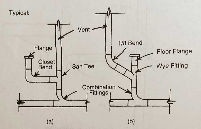

Dropping the toilet into a fitting on it's back needs a wye or a combo fitting, not a santee. With a santee, the poop hits and spreads both ways. The planned vent there would soon fill up and be blocked. Anytime I plan for a toilet, it's a 90 and downstream of the 90 I either wye off for a vent or I wye the line into a waste line. No tees on the horizontal or on their backs.

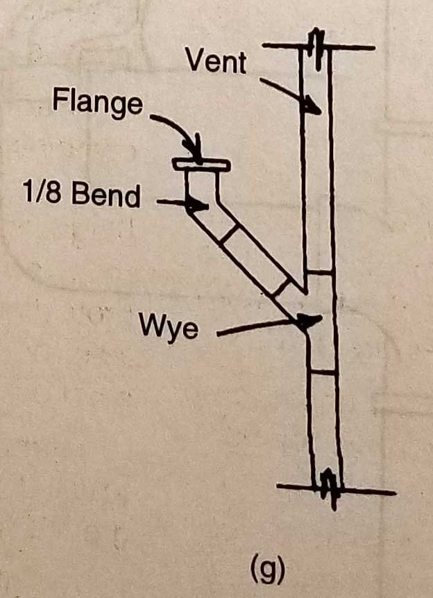

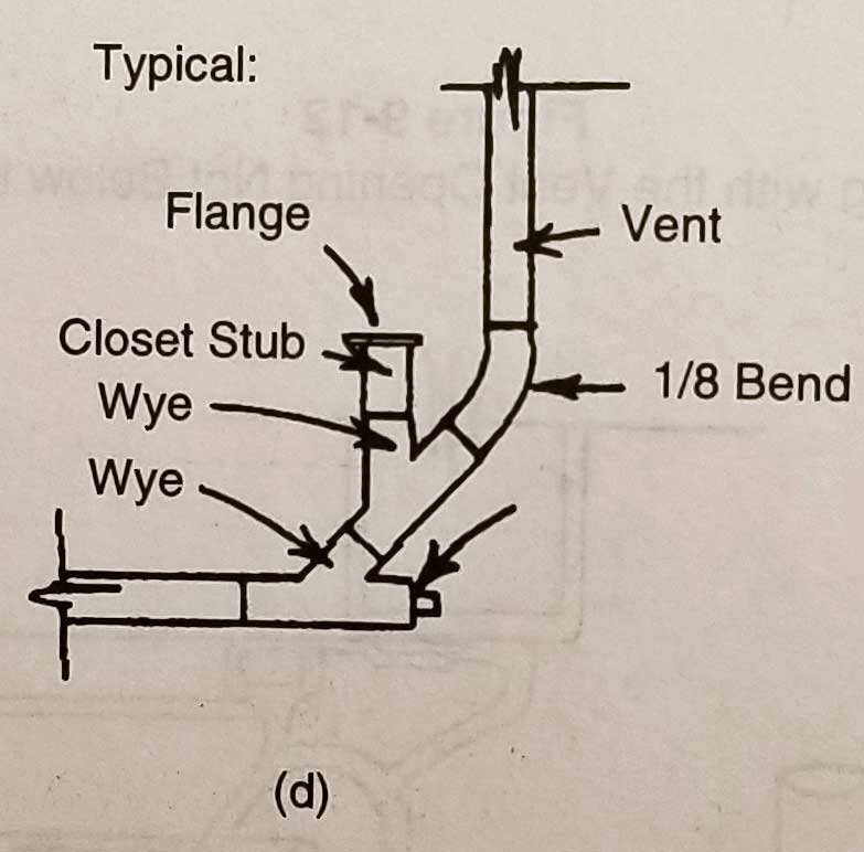

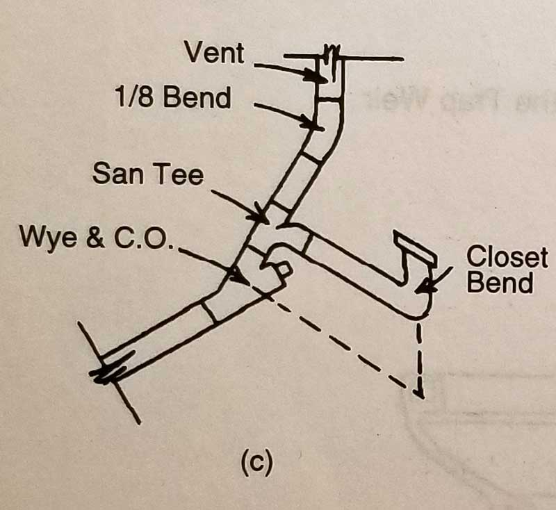

The plumbing codes have pretty much eliminated flat vents as a standard practice anymore. If you can aim the toilet drain towards the wall so you can run a vertical vent in the wall then you would be safe as far as code goes. If you can't run the 3" directly under the wall then you can aim a wye and 1/8th bend at a 45 degree on the vertical to go into the wall with out running any part of the vent horizontally.

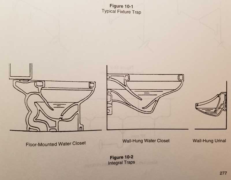

3,480
As I understand it, wet venting is for the bathroom fixtures on the same floor.
His drawing would be a vertical wet vent. It should be fine.
Tuttles Revenge
4,459
1,575
Sure, those are all standard. But say you have some obstructions like in the OP, or like the red framing in my markup below. Can you do a vertical offset in the horizontal WC fixture drain before the vent? If not, what prohibits it?
Cheers, Wayne
Toilets are weird.. They don't rely on the vent to break their siphon but the vent is there to equalize the air pressure from the flush of the toilet. Offsets are not prohibited in a tailpiece. But in any other fixture a vertical offset would be a problem for a trap arm.. but toilets are weird. I can't see any reason that offset would cause the toilet to not function..
My '09 training manual states "Because the water closet ... does not need protection from siphonage and because the method of fixture connection to the trap arm, the water closet .. may have a vertical portion in the trap arm. ..."
