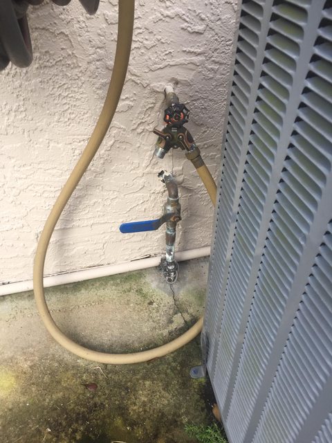

You should have a main shut off to the house. When you get your plumber to replace the washing machine shut off box have them show you how to shut off the water to the house. There should be a shut off right after the water meter. If you don’t have one easily accessible have the plumber install one. It beats turning off all toilet, washer, sink supplies.
We are in Florida and don’t have issues with freezing like you have, so our shut off is outside. It’s a simple 1/4 turn ball valve. Every time we leave the house overnight or longer we shut off the blue main handle in the picture below. I turn it off easily with my foot. I also shut off electric to the electric hot water heater.
When I get home I am going to check if that is outside of my house. If it had been the cold water line I wouldn't have known how to turn it off.
I am hoping the valve can simple be screwed on and off. I will keep everyone updated because you all have been so helpful.
You wont have a shut off like that in Denver. In Florida and other non freezing areas yes. but do find out basements are very common in Co but assuming you dont have one. city water ? long meter key might be needed but by all means find shut off . might take a few minutes to look for it
