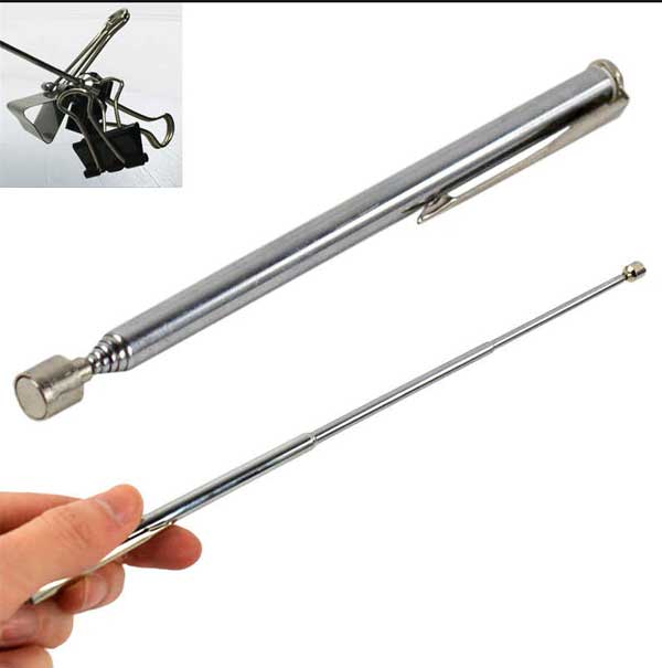

Happy Holidays! Today I was enjoying a beautiful day golfing and came home to a clogged kitchen sink. I tried to snake (25ft manual) from under the sink, but no luck. No external clean out so went to the roof and sent snake down the air pipe (1 1/2"). Thought it had a stop, but nope, it just slid out of the case and down the pipe. I can feel the end about 8" down but can't retrieve it... any suggestions on how to get it out?
* I've tried fishing it out with another snake & also a metal pole with screws in it to try and grab it (no luck).
* Also, I just went under the sink to see if I could grab from below...and managed to unclog pipe, so now it's not an urgent problem.
2nd question- Can I just leave it in there? Will it make it out to the main? (it's 75ft away)

The old wire hangers makes a good fish hook. A magnetic pickup tool might work if you can reach it. They extent to about 18" or a screw pickup tool.
33,562
1,010
Put a wire loop down a tube. Slide it into the vent so the loop goes around the snake, pull the loop tight, and lift the snake out of the drain. A magnetic tool will stick to the snake but will NOT be able to pull it out. DO NOT "leave it in the drain, because "stuff" will build up around it and cause a stoppage and the stuck snake will make it much more difficult to unstop the drain.

I've tried a magnet, but it's 25ft of steel and the magnet is not strong enough.
The grabby tool would work, but it's not long enough.
I can insert a piece of wood/steel/etc down the vent 4-5ft and then I feel it, so then I put a flashlight down and could see the end (the coil, not the auger tip, thats the other end 25ft down my pipe).
*that managed to fall off & now is in my pipe too *ugghh*
I've tried a couple other long pieces of poles w/ different screw configurations, all trying to grab/pinch the cable, but no luck. I've looked online and have seen a tool called wormer tool- will probably try that next.
