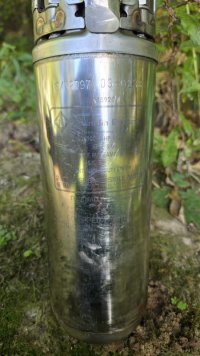

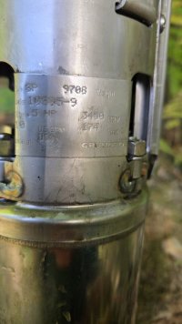

Finished the removal and install of the 10SQ07-240 yesterday. Pulled up a 1/2hp. Franklin motor paired with Grundfos pump on 200ft of poly pipe.
Probably never see a 27-year life even on the newer pump with CSV.
And some electricity savings after running 16A and now 6.4A.

When a pump is running at dead head ( shut off) amps lower. Its not doing much work.
