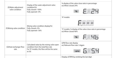

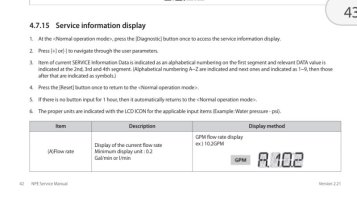

It is most likely the water access valve (WAV) or the mixing valve failing. With water running press the diagnostic button and arrow down to E and F. Watch what the valves are doing. One of them most likely needs replaced.

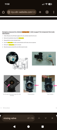

Here is a picture of the mixing valve and the stepper motor that controls it from the Navien service manual. These mixing valves cause problems. You can go into the settings and disable them. You can also manually disable them if they fail. The picture linked below is to manually disable the mixing valve.
