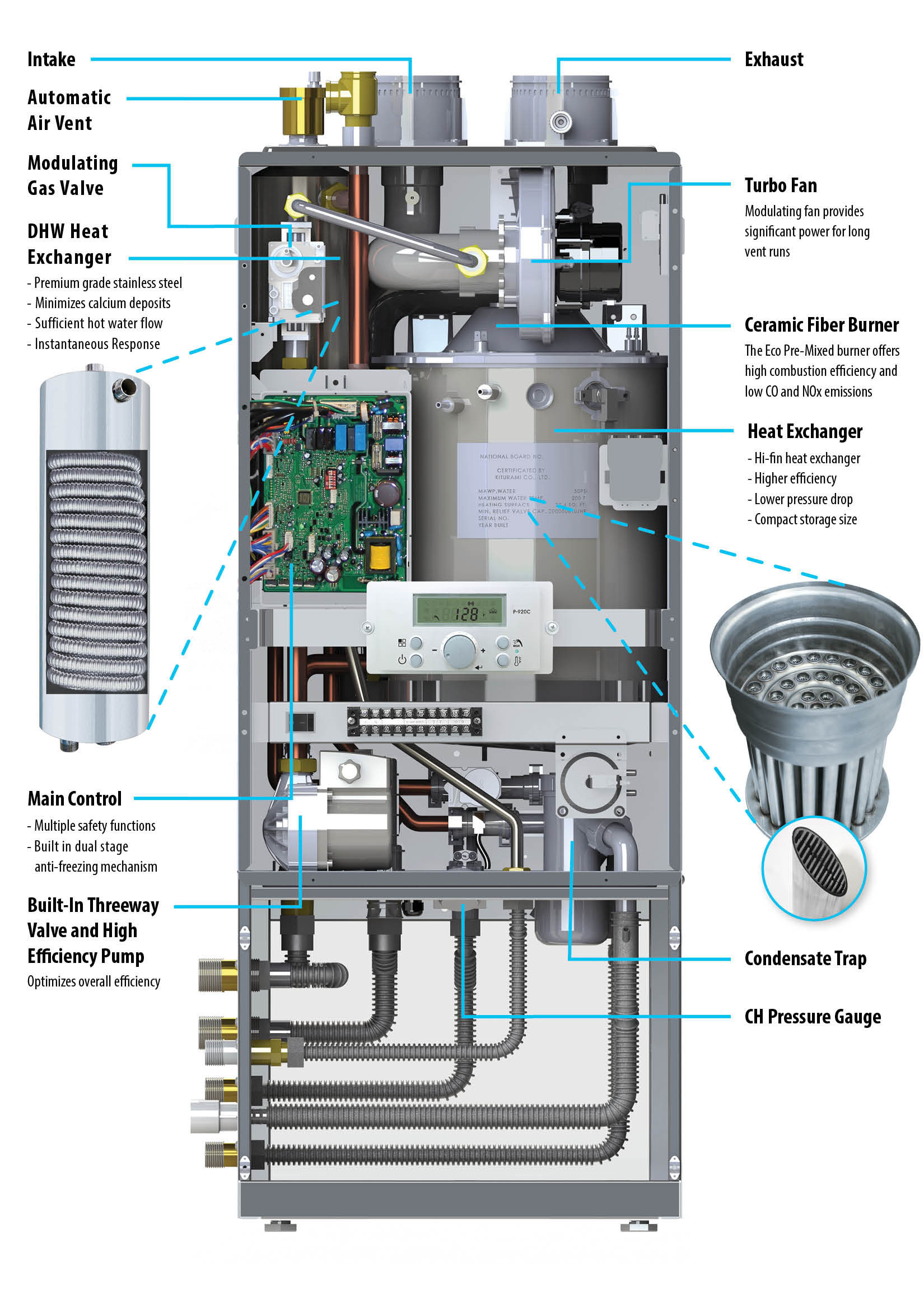

My configuration install looks 100% similar with the attached image, having only one zone. Anyhow I can control the temperatures on each individual room by either using the smart thermostat or/and the TRV's.
- Pump: Taco VR1816
- Heat emiters: Myson panel radiators with TRV's on all of them
- Relay: Taco switch relay for only one zone
- Ecobee thermostat.
My question is this: Is it possible not using the Navien manifold primary for NCB series? Just simple supply and return lines (in /out ) .

The heat exchanger in the Navien is a water tube type with a high pumping head, and isn't designed for high flow rates, but also requires a minimum flow rate to avoid microboil on the heat exchanger from becoming macro-boil, reducing heat transfer efficiency.
That said, if you do the math you may very well be able to find a pumping rate that meets the requirements of both the Navien and the radiation. If you don't do the math you're just hacking, and all bets are off (possibly including the warranty.) You may have to replace the internal pump inside the NCB (labeled "H" in the lower left corner of the diagram) with something else to make it work. That pump is sized correctly for the heat exchanger's pumping head assuming only a modest amount of pumping head from the exterior plumbing (such as the pre-engineered hydraulic separation manifold you're trying to get rid of.) Your radiation loop has substantially more pumping head than just the hydraulic separator, but for your system the radiation pumping rates probably don't need to be very high.
It's also possible to use something other than Navien's pre-engineered manifold as the hydraulic separator, either your own closely spaced tees made up from fittings, or a massive high volume hydraulic separator to mitigate against short cycling.

So the pre-engineered manifold is just to protect the heat exchanger?
I don't know about "...just to protect the heat exchanger..." - it's a system design issue. As with any hydraulic separator it's there to be able to allow different (both higher and lower) flows to the radiation than through the boiler. Fat piped low-head cast iron boilers aren't very sensitive to flow rates. Water tube modulating condensing boilers are sensitive to flow rates, so primary/secondary plumbing separating the radiation & boiler flows are customary with that type of boiler.
Fire tube mod-cons are less sensitive to flow rate than water tube boilers, and can often be drop-in replacements for systems previously heated by cast iron without hydraulic separation. If you're going to be doing this in hacker-mode, no math you'll probably have better luck at finding success with an HTP UFT-Combi than with an NCB, due to it's fire tube heat exchanger, which can be direct-pumped over a much broader range of system configurations, even though all the examples in the manual show closely spaced tees as hydraulic separators. It comes in both wall hung and floor mounted versions (floor mount shown.) Westinghouse sells the exact same combi boilers through the orange box stores.
Note, these too come with an internal pump and expect somewhat lower pumping head on the exterior plumbing.

Sure there's only flow when there's a call for heat but is it the right flow for both the radiation and the boiler?
Without looking up the specs or doing any of the math...
Lets say you need 4 gpm on the radiators to get the right amount of heat into the system with the given radiation, and the heat exchanger on the NCB needs to operate between 1-3 gpm. How are you going to do that with one pump, and no hydraulic separation?
Conversely, lets say you only want 1 gpm on the radiation and the minimum flow requirement for the NCB is 2 gpm. That might be do-able without hydraulic separation, but you have to design it.
Then let's say both the radiation and boiler are happy with 2-3 gpm. How do you know if you'll be able to achieve that flow with internal pump in the NCB without doing the math on the pumping head for the radiation loop?
To date I have never done the math on pumping direct with the NCB with either it's internal pump or a different pump, and I don't know the actual specs on what it really needs. But as with any water-tube boiler I absolutely WOULD do that math if I were contemplating pumping direct, to be damned sure it would both deliver the necessary heat and not burn itself up.
Also, dealing with big (150K+) modulating burners requires doing the math on the gas plumbing and getting that right too. Pulling a permit? Are you even allowed to install gas fired equipment in WA without a gasfitters license? (I don't actually know the answer to that.)
Seriously, if you're not going to do the math, use a condensing tank type water heater and a flat plate heat exchanger, an approach highly tolerant of gross hackery-tinkery (unlike water tube mod-cons):
