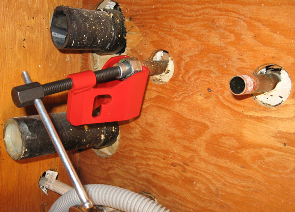

We use a sleeve puller to remove the back nut and sleeve.
How well does that puller work? I would never reuse a compression fitting but lacking a puller, I split the ring and clean up the pipe before putting a new nut and ring on it.
32,772
1,191
Cutting the ring off could leave a score mark and make the new one hard to seal. I've been lucky, in the few I've had to replace, they weren't overtightened, and the ring came off with little trouble.

We replace about twenty compression stops a week using a puller. It slides off the sleeve and the back nut comes with it.
Then we replace the chrome escutcheon, Emory the copper, much like honing a cylinder, and slide on a new 1/4 turn stop.
You can cut the sleeve off with a hack saw, but any little slip and you have notched the copper.
The sleeve puller is very quick.
If the copper has been deformed by a previous over tightening, we can cut it back behind it and still install a new shutoff.
Out of the hundreds of stops we replace, we have almost never resorted to using a torch.
But then we do this all week long, on about 1/3 of our jobs.
