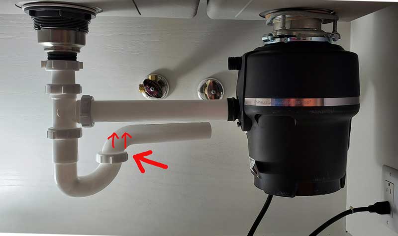

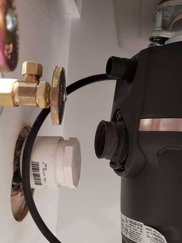

OK guys finally got the countertops installed and with that the sink. I've installed the garbage disposal. Here are a couple pics of where its sits in relation to the drain line.
What do you think, will it be alright as it is? If so any recommendations on the best way to plumb it?
Somebody should have warned you to put drain outlet on the left side of the cabinet.
That's where it was. It would have been a nightmare to move it. I'm in Florida, block exterior wall. I know I'm going to have to go both directions with it. Was thinking I'd go over to the other side with a T which has the trap on the bottom then back over to the wall. If that makes sense. It won't be the most efficient but pretty much my only option as I can see it.
Pictures can sometimes be deceiving but it doesn't look like you'll be able to hook that up without moving the disposal to the other sink. like I said sometimes pictures are deceiving.
Guys... I just have the outlet rotated to the back to show the height of the drain outlet of the disposal in relation the the drain line. If you look at the first picture you can see the outlet pointing towards the other sink. There is enough clearance to have the drain line after the trap on the opposite side to run behind the disposal. Not sure if the makes sense.
I hope that coupling isn't glued, so you can put in the elbow that would probably be needed if the disposal stays on the right.
How about putting the disposal on the left?
Yes, try the GD on the left sink, you may be able to make it work. If not, get creative with 45* and some cut to size pipe.
So it's a 60/40 sink and we want the disposal to be on the 40 side. And no the coupler is not glued on it's just pushed on. Had to keep the fumes out while I was building the cabinet. I'm going to do my best to make it work as it is. Fingers crossed I can.

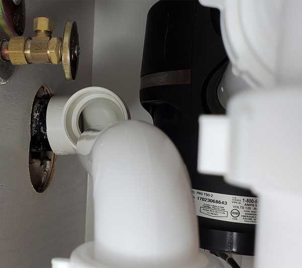

OK so here's where I'm at now. There's plenty of room to run the pipes I just need to know if it's OK to put some kind of riser out of the p trap to get it high enough to be at the proper elevation to run down to the drain line?
You can swivel the p-trap.
You have ABS out of the wall. You need ABS pipe and glue for that.
Also and ABS trap adapter.
I wish with the deeper sings they would redesign the p-traps with less height on the end. Please remind me to call them on Monday and ask for a redesign of their standard p-traps.
In the meantime, they do make the one that reverses. Not my favorite way to fix this but at least in makes the connection.
A reversed p-trap
I have abs glue. I know I can swivel it but the line oming off the p trap to the drain is too low as it sits. Can I put a riser to get it higher?
