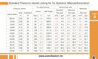

I have a chlorination/dechlorination system. Soda ash injection -> Chlorine injection -> contact tank -> carbon -> softener. I’m removing 12ppm of ferrous iron. The issue I’m having is some ferric iron is making it through the carbon filter. I’m assuming from turbidity from the contact tank.
I have soft water from the well already so I’m converting my softener to a Katalox Light filter and can’t decide between AIO and without. I like the idea of non AIO if it will work since it’s less maintenance (cleaning injector etc.)
Any help or ideas would be much appreciated.

Does your contact+settling tank have a blow-off valve to let you blow out sediment? Maybe consider at tank to let the sediment settle, and get blown out.
Note that KL takes a lot of backwash. A 10 inch softener backwashes with 2.4 gpm, and KL in a 10 inch tank needs about 8 or 9 gpm. A Fleck 5600 cannot do that.

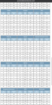

8 or 9 on a 10” tank? Here is a link to the different medias and flow/ backwash rates.
Also here are 2 screen shots. I have a WS1 anyways I should be good. My supplier sent a 6gpm DLFC. Thats what they use on all their Katalox set ups.

Expect your KL to cake up at that level. I would like to see about 35% bed expansion.
Also, you don't want to keep the top basket in place. It will gunk up. See #32 and #33 of https://terrylove.com/forums/index.php?threads/change-fe-filter-to-katalox.81045/page-2

Hey you know more than I do. I’m still learning lol. What size Dlfc would you recommend? I did order the air blocker that clack offers. Would you recommend that? A lot of people don’t use it. Clack also offers a deflector that some use on AIO set ups part #D7147. I had another person say he doesn’t even use the check valve in the inlet of the valve as well. Yikes!

What temperature is your backwash water? I would tend toward 8 gpm, and you have to make sure the drain line and pump can support that flow.
The recommended Backwash rate for Katalox Light media is 10 -15 gpm per square foot of cross section, so for a 10" diameter tank, that calculates to be 5.4 (minimum) to 8.1 (optimal) gpm. This flow range is suitable for 20 to 30% bed expansion, but as suggested, further increasing the backwash flow rate somewhat could acheive 35% expansion with no negative issues resulting.
Due to the heavy, sticky nature of ferric iron residue created when converting ferrous iron to a ferric state, there will be an immediate benefit to using the higher backwash rate when posssible, to ensure the iron residue including that trapped within the media near the bottom of the tank, will be released and discharged as rapidly as possible.

My media is Centaur Carbon, and only 0.4 ppm iron. H2S was my main motivation. So 5 gpm is enough backwash with my 10 inch tank.
During backwash, monitor the pressure to see that it maintains at least 30 psi. Maintaining 40 or 60 is not needed to get backwash if the drain line is low backpressure. Also, if your drain line is 1/2 inch and/or a bit long, consider increasing to 3/4 inch. The pressure that matters as to whether you can maintain 8 gpm is the differential between the input and drain line. Backpressure on the drain line can make the backwash weaker.
