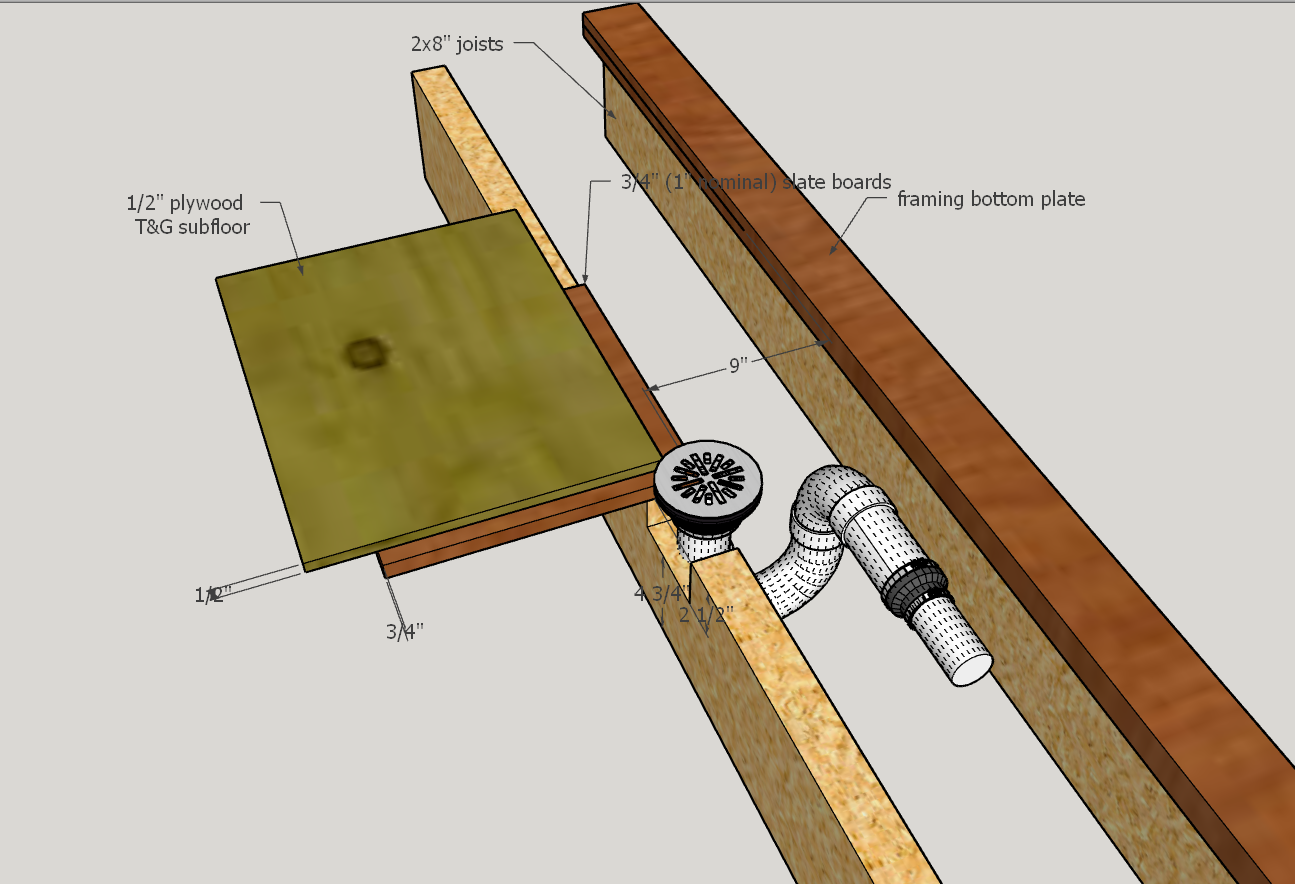

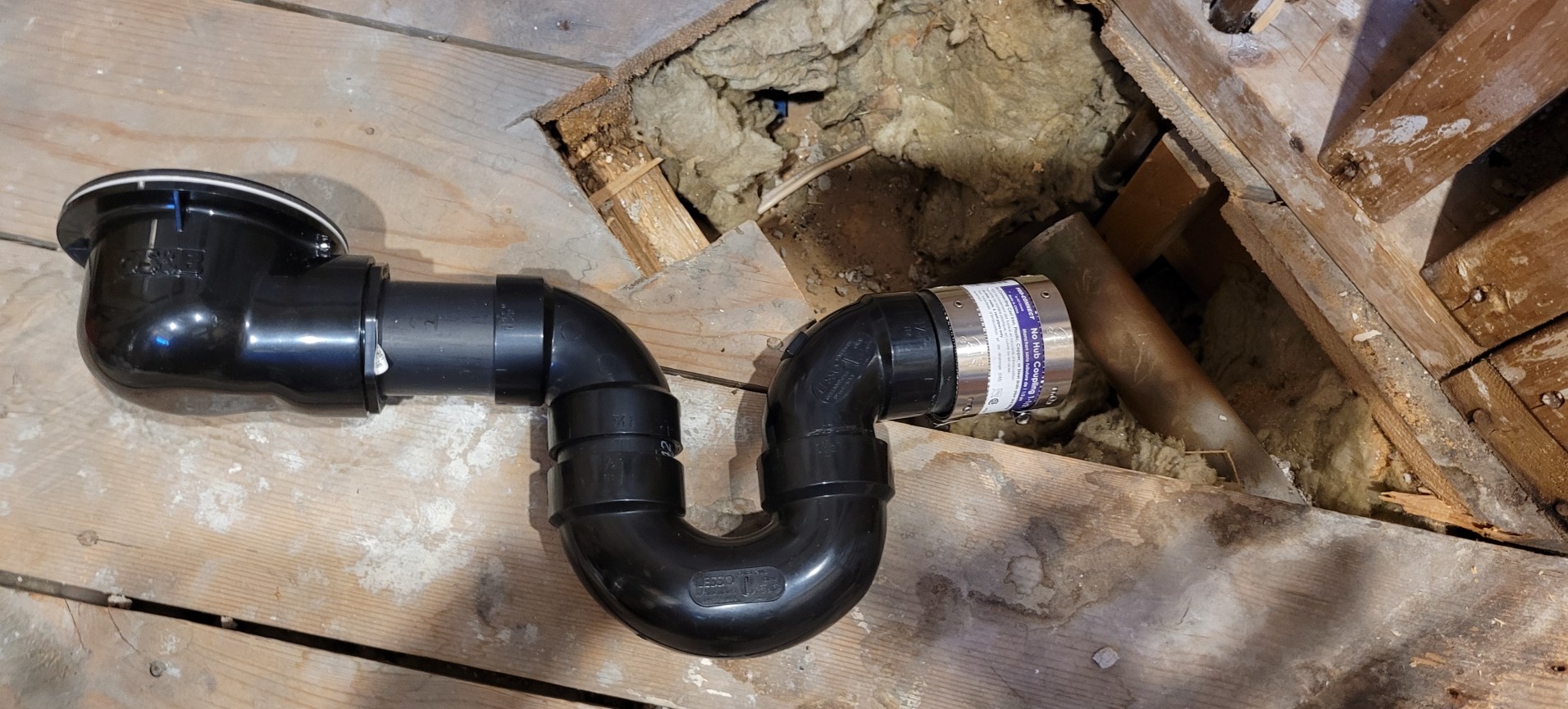

Below is a diagram showing my situation. I am replacing a bath tub drain that you can see in the second picture
The problem is that even a 2" offset shower drain will not fit there. My plumbing is 1.5" copper and the plan is to connect with a flexible shielded connector from 1 1/2" ABS to copper. But before getting there I need to install the shower drain which does not fit in the notch that the original plumbing was using
As you can see in the diagram, the shower base requires the drain to be 9" away from the the framing bottom plate which positions the shower drain just above that joist which is already notched but not enough to actually fit even an offset drain (that needs a 2" to 1.5" adapter and that requires more room below the drain.

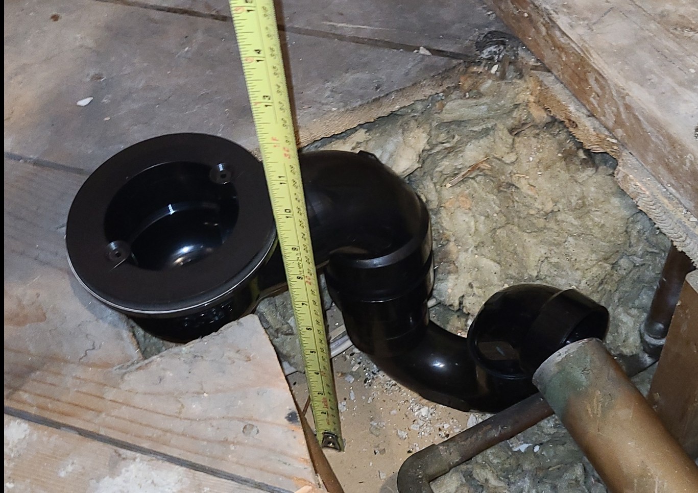

Here is what I ended up building, any problems with this (other than the 2" to 1.5" conversion which I know it is not up to code but it is not practical to do it otherwise here)

That style of reducer should not be used on the horizontal like that--your configuration will hold ~1/4" of standing water upstream of reducer. On the horizontal you need an eccentric reducer, such as the following (in PVC)
Or you could use your reducer on the vertical if you can make that fit.

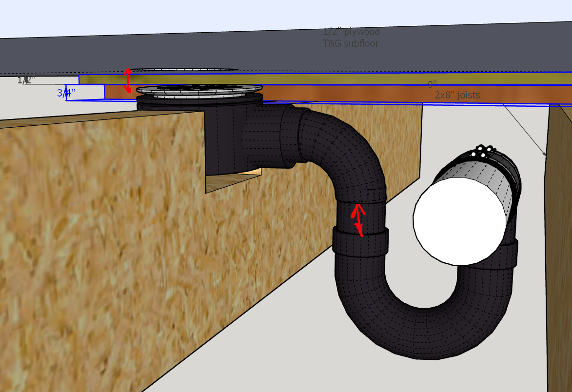

If I use only the components of the original p-trap as bought from the store it will look like this but on the downsteam end of the ptrap I will not be high enough to get the the level to the existing plumbing (copper drain in the picture)
I could do this if these if they are allowed:
-use a 90 with hub connectors (H in the picture) at both ends
-use that raiser piece to get back to the elevation of the 1.5" copper pipe (drain)
-minimize the connecting piece marked with an X in the picture (otherwise the shower drain gets too high above the floor
(I still need to install 1/2" subfloor, 1/2" cement board to support tiles -see the third picture for how high above the floor the shower drain gets pushed if I use the reducer on the vertical side. Not sure if there is a male only elbow 2"

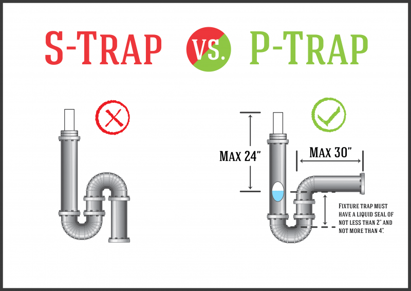

Why is raising the trap controversial>? Not saying it is not but I want to understand what would go wrong if one does that
Found this online
OK after some wrestling with chatgpt I extracted this answer
Here’s the risk if that distance is greater than ~4":
  • As water flows out of the trap and into a longer or lower trap arm, the water column creates siphon suction.
  • That suction can pull water out of the trap faster than it refills, leaving the U partly empty.
  • Once the water level falls below ~2", the trap seal is lost and sewer gas can enter.

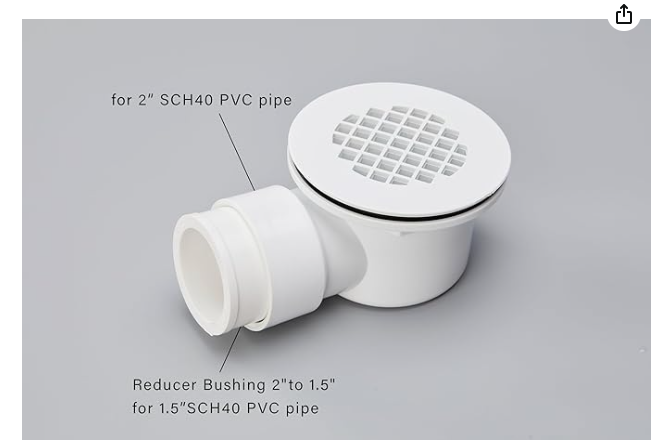

Would one of these work? I'm not clear on whether the part that mates with the shower pan is always a standard size, or it can vary.
(All I did was google '1-1/2" side outlet shower drain')

I have the Canadian equivalent of the above
this matches my shower base
Not sure why I would change it, what would be the problem if I use the reducer in the horizontal position ?
How bad can it be if the water sits there ? I could pour some resin or caulking to level the bottom up with the 1 1/2" pipe
No, the equivalent would be this one:
Which has a 1-1/2" outlet, so you don't need a reducer. Then to minimize drop to your trap, use a 1-1/2" street quarter bend directly into your 1-1/2" trap.

Already spent 70cad for the one I have, restoking fee is 25%
Still don't see the big inconvenient if I use the bushing in horizontal position. I agree that some water will always be there but since we all clean the shower after using it it will be mostly clean no smell if left there till next day. I will have to take extra care to make sure that joint does not ever leak or cracks but other than that I do not really see major problems
