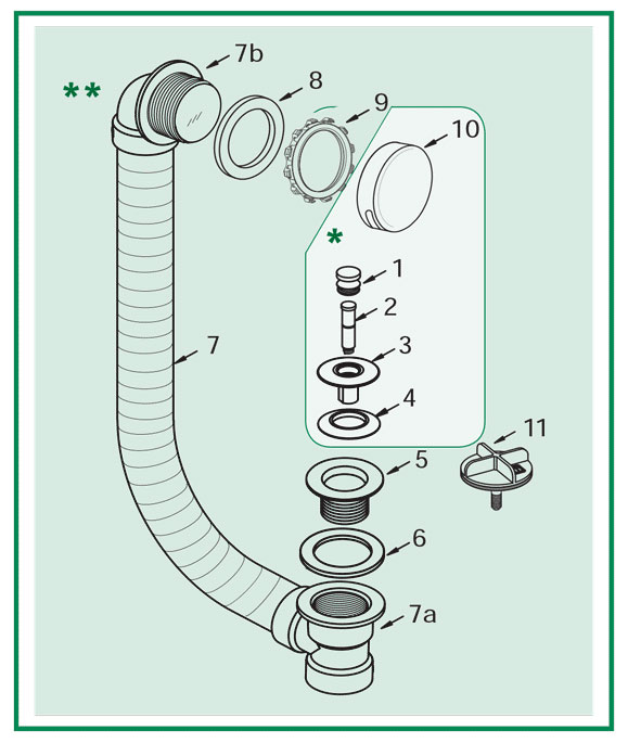

You will need the p-trap in that location. There are several drain styles that will work there, and maybe this one by Watco would be the easiest.
It would connect the overflow and let you use the current p-trap location, or at least very close. I would count on picking up a new p-trap, coupling and some 1-1/2" pipe with some glue at the hardware store. I often wind up cutting out the old and putting the new p-trap right where I want it.
A few different styles here to look at.
Right now you have the black ABS pipe. If the drain you pick up is the white PVC, you will need a shielded coupling to convert over to PVC.
If the drain is PVC, I would use that for the p-trap and the drain.
https://www.watcomfg.com/watco/Instructions/WatcoFlex_Bath_Waste_Instructions.html

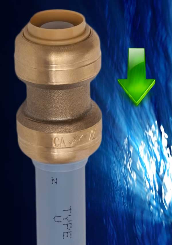

I would pick up a new pressure balanced single handle tub faucet while you are at it.
They also have a polybutelene x PEX Sharkbite at the hardware stores to go from gray to PEX.

We had bought the almost identical faucet as the one currently in the wall. Is this a bad idea? We also worry the poly pipes will get in the way of the overflow drain kit. Also some concerns about the electrical cord that runs directly under the prone-to-leak piping.
We are looking for methods to raise the tub up safely and securely with limited construction knowledge, if that's our best option. I see styrofoam and some tubs have tub legs, but unsure if there's some sort of DIY kit to build a platform around the floor hole.
I just ordered 2 of those conversion fittings so we have them on hand. I also ordered the flex overflow/waste you advised. I'm at your disposal, NASA. I'm so very, very thankful to you.
