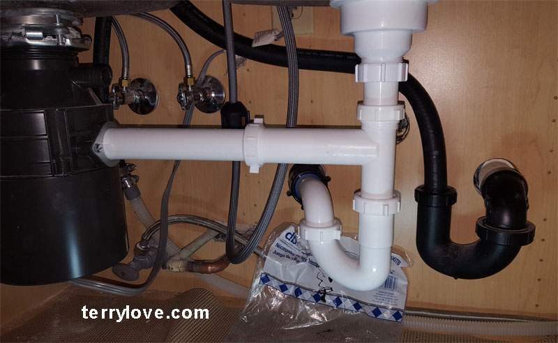

I am installing a garbage disposal (1/2 hp, Insinkerator Badger 5) under a double-sink. I would like some help determining how to plumb the sinks/dispoal (no dishwasher). I have a picture if someone offers to help off-line.
Right now, the discharge hole/port from the disposal would line up with the horizontal pipe that leads to a t-coupling (conntecting the drains from the two sinks), then down to a p trap and up to the waste pipe. Ideally, I'd be able to just cut that horizontal pipe (meaning, cut a new horizontal pipe) and connect it without making any vertical changes in the piping (I've probalby lost you by now). But, the instructions say I should have separate drain traps for each side. And, the disposal comes with a "discharge tube" that comes out and goes 90 degrees south. If I had to put on that discharge tube, it means a lot more re-configuration, as I'd have to either have those separate traps leading to the waste pipe. And, I wouldn't even know how to set that up.
Anyhow, that's enough rambline b/c I'll only confuse us more. Is anyone aware of some basic double sink garbage disposal installation instructions? Can anyone help out with my specific situation? Drawings?

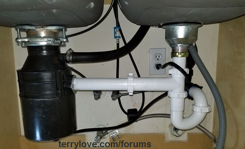

You can use two p-traps, or pick up a "disposer kit" with a baffle tee that goes straight out from the disposal.

I saw that diagram and thought it was helpful. The problem is that the disposal I have says that I should use separate drain traps for both sides. Why would you think that is required?
Also, I'm not sure what I'd do with that discharge hole -- not sure if the discharge tube they provide is specially fitted/seated such that the horizontal piping won't fit there. I have a link to the instructions here:

InSinkErator's preference for 2 drain traps
The InSinkErator instructions call for 2 traps on item 4, step 11, middle of page 5 in the PDF. ("If you have a double sink, use separate drain traps for both sides.") This is true for both the one-bolt and two-bolt discharge tube installation.
I'm also told (by a How-To brochure on disposers I picked up a Lowe's yesterday) that many local communities require two drain traps by code.
I am about to replace my old disposer with a new one and I can't imagine adding a second trap. Major hassle since cutting in my kitchen wall would be required, rather than a quick 30 minute swap.
Any thoughts on why InSinkErator and some local codes suggest it?

I see where it mentions that they prefer the turned down pipe, but that you can use a straight pipe out of the disposal. 11-2
Insinkerator is mainly what I install.
Many sinks have two bowls, it's not uncommon.

Plumbing codes don't allow two traps on one trap arm.
To have two traps, you would need two trap arms, each one properly vented.
I don't know of very many sinks that have been plumbed that way.
Most only have a single trap arm roughed in.
A cross fitting in the wall would work, if the waste and vent were vertical.
If you has a trap arm coming from the side, that you can't add the second trap.

IF it says you need two traps, then the instructions were written by some engineer who had absolutely no idea about how to do it. The standard disposer, (not Disposal continuous waste is all you need.
What he is trying to overcome (I believe) is the restriction in the outlet tee.
If one was to not use the trap @ the disposal and tee the discharge in above the other sink trap with a tee with no baffle (and 45 degree offset so as not to introduce flow into the second bowl), would this be OK? Or if one installed the trap w/o baffle @ the disposal and tee'd the second bowl into (above) that trap, would it muster?

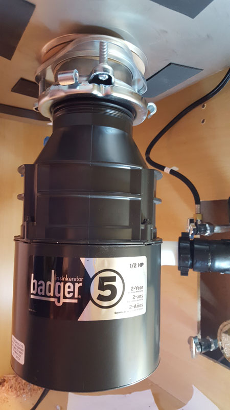

I'm in a conundrum of sorts with this drain configuration. The Badger 5 comes with a downward discharge tube, which would then run into an elbow and over to the other sink drain (I've included google picture I found for reference). The picture posted here of Terry's shows the discharge tube coming straight out across to the other sink drain. What are the pros and cons to each way? Does the discharge elbow allow better drainage for less corrosion, or does it not matter. The plumber who plumbed the house when new did it the "straight out across" way. Suggestions would be appreciated. Thanks much!
35,502
3,663
Why do you ask? Are you having a problem with your current installation?
Maybe post photos of your sink and drain. The first picture you posted does not look so good to me. The horizontal pipe does not look like it is higher than the trap adapter. You should be looking at what will match your situation, right?
If you have not yet bought the Badger, consider upgrading to Evolution.
Straight does not go down, so if your trap adapter is not low, that could be good. I am not a plumber.

I appreciate the feedback, but didn't want this to be over thought. My current Badger 1 is nearly 20 years old and doing the typical rusted through and leaking through the motor housing out the bottom. My setup is "picture b", discharging straight out and across. Before I replace it with a Badger 5 (I know, just as cheap, but I can't afford any more), should I just replace it and discharge straight out across again, or should I put more work in it with the two elbows as shown in "picture a". I didn't know if the two elbows setup would have advantages over the straight out across setup or if there's no benefit of one over the other. Thanks!
