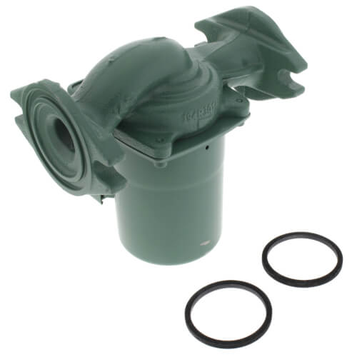

From the looks of it your pumping towards the expansion tank. You should be pumping away from it
The supply out of this boiler is straight out the top, the return is in the back or the boiler, at the bottom.If that's a Taco pump, looking at the pump in the orientation the electrical connections would have to be on the left to be installed backward, pumping toward the expansion tank. Note the arrow on this Taco pump, relative to the electrical box:

The orientation of the air scoop and pump are correct, but the installation of both are ridiculous. Both need at least a foot of straight pipe coming into the intake side from the last ell, and it's far better for the pump if it's in a straight line from the expansion tank without the intervening ell.

The direction arrow on that model pump is probably on the bottom of the pump housing, but it still looks like the correct direction.
