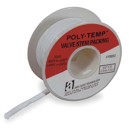

Rather than using Teflon tape, I use Teflon packing that comes in various thicknesses
Great for larger valves as well as smaller diameters. Works great on packing glands for pumps

I've used and did carry some that was 1/8" round but small valves tape seem to work.

When I was a stationary engineer, I used it to pack a lot of pumps and large steam valves 8'-10" on the smaller valves stuffing box I used a razor to trim the Teflon, as it seemed to work better than taking tape or rolling it into a strand
Graphite was the best, but they outlawed asbestos
