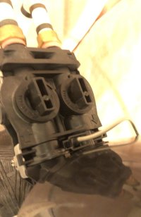

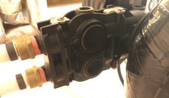

As for paddlewheel vs turbine, is this what I should be looking at? See photos attached.
I feel like the current settings are wrong somehow. I started a regen last night. This morning I remember the remaining capacity was around 1000. Now it is saying 397! I don’t think we used that much water. Do you think it’s the settings or something else is flawed here?

Hmm yeah something is not right. I just took a shower and then went down to check. It was 397 remaining before and now 305! I couldn’t have used 92 gallons for a shower! Is this a configuration problem (flow rate) or a hardware problem?
The component with the white wire protruding from it, located between the bypass valve and the control valve, is a Turbine flow meter.
Bannerman
4,384
632
Ontario, Canada
With the Flow Meter setting programmed as P0.7, the control valve will calculate 1 gallon soft water consumed for every 20 pulses received from the flow meter. A Turbine flow meter will send 133 pulses for each gallon consumed, so with the incorrect Paddlewheel setting utilized for a Turbine meter, the control valve will be calculating a much greater quantity of soft water (6.65X) than is actually being consumed.

Yeah it looked like turbine to me based on the link you included. Ugh. I’ll fix that today. Is it t0.7 for sure or can it be something else?
36,590
3,892
The service manual page 2 column 2 seems to imply that the 1-inch turbine or paddlewheel are not used.
