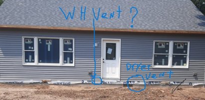

possible WH vent to the left of the front door then porting away from the door 2-3' and to the right of the door the dryer vent and using one of those gravity vents to keep cold air from drafting back into the laundry and in the house. and to keep it a bit higher than the 12" for possible snow drifts? most likely i would need to run the WH up some for that same reason. so if i can do the WH would i need to put the vent exhaust further from the wall or would the heat be dissipated enough by the time it ran 20' from the WH to the end of the vent?

Your vent needs to come out of the roof if your going to come out on that side of the house (in the picture) you can't vent a water heater within ten feet of a window. The exhaust gas is poison. You need to pipe it out the roof. Unless you want to change the windows to windows that don't open.
ok i forgot about that. thanks for that reminder, we sure do not need that issue. so it is back to the drawing board. this is kind of evolving thing. the furnace guy is looking at now putting the furnace back in the crawl space if he has the room for the plenum. and then using the closet they made for the furnace to put the WH in and vent thru the house roof on the back side. but if he can't do the furnace down in the CS then put the furnace in that closet and put the water heater in the garage and maybe it has to go in a closet insulated to help keep it warmer. and then venting that thru the garage roof. so i guess we will see. i'm just looking for options. i'm also looking at a tankless gas WH but now you got me thinking that may not work either as it will be direct venting out the back wall and again it will be withing 10' of windows. but i will measure that distance tomorrow to see. and if i was to vent a tank less out the back wall it will be 90% wast wind so again that may be a good distance but the wind may just blow the vent gas into the house when the windows are open.

Condensing wh the flue and combustion air have to be on the same side of the building can use a concentric vent termination kit only one hole for penetration.
ok guys as it turns out i can put either type of tankless in the crawlspace. the plumbers were out to set the hose bibs and turn the water on. and i was talking about someone saying the vents have to be 10' from doors and windows that will be open. they said here it is 3' to open doors and windows so they said i can do either type of heater as i have the distance per code and the plumbing is stubbed there and i have a drain for condensate. they recommend the condensate type as they are more efficient. they said that is the only type they install. so it may be back to the beginning. i'm going to shoot the inspector a photo of that area and see what he says. if he is good then i will get one soon and install that.

I don't think it's that simple, but I use upc guidance for these things. Upc water heater section (chapter 5) is like 50 pages, ipc (Michigan) is like 3 pages.
Generally the water heater you get will have vent termination information with it. Use that and guidance from your local plumber.
I can tell you that the best way to do it is to terminate through a roof. If it's easier and more logical to go through the wall below a window jusake sure your looking at the information that comes with the heater you get and checking with the local inspector.
i would use that guideance but i hate to buy one and then find out it will not work. and like i said i have the water lines all stubbed out now for putting one on that back wall and i can get a condensate unit so i can run 2" pvc directly to the back rim joist 4" from the unit. i can move it over some to equal out the distance between the windows. the inspector said to go by the install instructions but i do not see those when i looking at them online at lowes and menards etc. they have specs but no installation instructions for placing the vent form a window. and i looked at the mfg website and i do not see instructions for installing them. at least for the richaman i think will work for me

All the distances/ clearances for flues/ combustion air are not from the manufacturer but from different codes. When you seen a drawing of a house in a install manual the different code organizations are listed at the bottom of page. That why there all the same. Flue / combustion air size, length, material and ells have to followed 100%.
