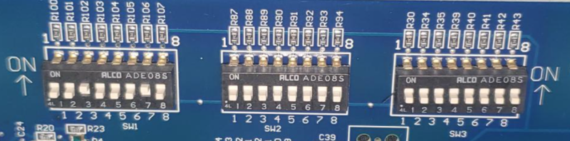

In 2024, I upgraded my well pump setup with a new Franklin SubDrive Utility UT3P System, expecting improved performance and reliability. Instead, I’ve faced a cascade of issues that have made me question this so-called “upgrade.”
Just two months after installation, the SubDrive unit failed completely and had to be replaced. Since then, the system has been plagued by intermittent shutdowns triggering fault code F6. Sometimes it runs for a day, sometimes for months but eventually ends up faulting again. Usually, but not consistently, under heavy load. Resetting the system restores function.
Unlike my old pressure switch and tank setup, which ran for decades without issue and was easy to maintain, the SubDrive system is proprietary and complex. I can’t troubleshoot or repair it myself. To my annoyance I've had to call the same techs that installed the system to troubleshoot the Subdrive system. My only answer from them being, it all checks out if it happens again call us and we can replace the unit.
After some research, I’m leaning toward the idea that these systems are designed to be difficult to service without professional help. The reliance on specialized electronics and fault codes makes DIY maintenance nearly impossible. Poor show Franklin! It’s a stark contrast to the simplicity and longevity of traditional systems. If you’re considering upgrading to a Franklin SubDrive Utility System, think twice. My experience suggests that while these systems promise modern efficiency, they often deliver frustration, downtime, and costly service calls. Sometimes, the tried and tested is the better way.
I am considered adjusting the dip switches to lower the horsepower setting from 1 HP to ¾ HP, hoping it might stabilize the system. This would underpower the pump. Would this be likely to cause harm to the pump? Franklin Electric’s own documentation warns against mismatched settings, see attached. Any other ideas on adjustments to the, dip switches, underload or pressure set point, that could remedy the issue? Can I disable the fault from occurring?

Yes, its frustrating as it seems to me that the error is not valid. There is no pattern to its occurrence, all the wiring and connections seem in order but there is no way to disable it and stop the system shutting down.

A lot of experts commenting here about 3 phase motors, the Subdrive Utility utilizes existing single phase motor so people are commenting on a product they have no first hand knowledge of, claiming to be "pros". In the 75+ Subdrive Utilities 2W or 3w the only failures were clogged transducer or surge/lightning related. The only trouble issues were always wire related. Since there was no mention of diagnosis of existing condition of wire with a megohmeter I assume that step was skipped. I would start there. Wire bleeding voltage to ground will be tolerated by a pressure switch but not a Subdrive or a Pump Tec.
Single phase VFD's are fairly new. I didn't realize the "Utility" was the new single phase model. However, you can tell it doesn't matter if single phase or three phase all VFD's give lots of problems. Could be a clogged transducer, surge related, or something else as there are many different problems associated with VFD's and varying the pump speed. I started having problems with VFD's in the early 90's so I know a lot about them, which is why I would never use another VFD on a well or booster pump.
