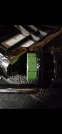

I think i found my issue , tore down valve to inspect , spacers and orings look good , piston has 3 scores in the end , I imagine this isn't normal and needs replacement?

A seal could also be bad. But the condition of the seal does not stand out like it did for your piston. Nice picture.
As the piston travels within the center void of the spacers and seals, for the piston's Teflon coating to be scored as it is, I would expect similar scoring damage to at least 1 seal.
Damage & wear to the seals is usually not visible due to the flexibility of the material utilized. The seals also will dry out over time, especially when exposed to chlorine.
