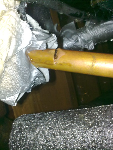

Did my pipe break, or did someone try to steal it?

I'm trying not to jump to conclusions but...
A little background with the photo. This happened the other night when the temps were about 31 outside. The pipes are all wrapped in pipe insulation, and we've had temps as low as 14 about a month ago for little over a week.

If it was a freeze situation, it usually splits along the length. Looks like someone started to cut it with a hacksaw, and decided they didn't like the resulting shower they got and stopped.

Doesn't look like any copper I have ever seen. The edges are "ragged" and it looks like the surface is "chipped" which is not typical of a copper cut. IF it is copper then it did not freeze because it would be bulged out at that location. Really need to see more of the pipe, especially back to a connection.
It looks for all the world like copper cut with a 10-12 TPI blade--a jabsaw or some such thing.

What kind of saw makes a ragged "S" cut in copper? It must have been a very crooked blade. All of my saws make straight cuts in copper tubing. They also do NOT chip the outside of the tubing.

It's copper.
I have no clue what he tried to use to cut this, but it was crude. He also apparently tugged very hard on the pipe at the same time because it had a good bend in it as well.
