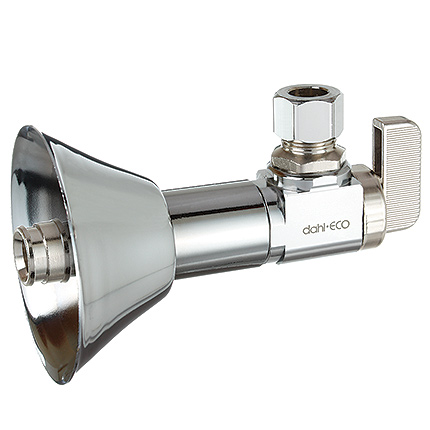

What I did for a retrofit where I fished the new piping thru the plaster wall:
I suggest somebody productize a PEX / Aquapex input stop valve, with a plate that screws to the wall. Better still, that plate could be covered with a standard or included split universal escutcheon. https://www.lowes.com/pd/Keeney-0-5-in-Chrome-Universal-Escutcheon/3131285
Or how about something like this, except there would also be a screw-plate that accepts screws into a wall and takes the forces:
So while the wall is open, the copper stub-outs would be ideal. But a nicer retrofit solution would be good for retrofit cases.
