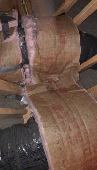

i have a new modular home that came with the cold air returns in the living room and both bedrooms. the walls are 9' high and the returns are 2' from the ceiling. we live in muskegon mi. so we do not see 9 months of needed a/c and we do not have central air. and i notice just before the furnace starts, i can feel a cold draft and then about 5 minutes the furnace starts up. so i'm kind of debating with the home builder company heckaman that they may need to be lowered. they said they do not need to be lowered as that is how new homes are now being built. but i still think they should be lowered as in the old house we never had that cold draft just before the furnace started, but we were in the upper section of that raised rance. the lower was a family room a bedroom a bath and utility room.
so can anyone tell me if it may be me or will it be better to move the cold returns down the wall to the floor level. the returns go into the attic as the house is now a ranch and has on lower living space anymore so the builder put the returns in the top of the wall and open into the attic.
now it may be the attic being cold and as the rooms start to cool that cold air is settling down into the rooms and we feel it. and my theory is if the returns are down at the floor level that cold air will be trapped and will not draft as the registers are at the floor also. and the CS is 95 or more sealed and has 4 heat vents down there as well.
so does anyone have a theory on this? should i leave it or lower them? thanks

the furnace is 2 years old what is going on is not the furnace as we can hear the draft inducer start up and then about 15 seconds later the furnace start. the draft is kind of like someone opens a door just a bit to let the dog out, and we feel it for maybe 5 minutes and then the furnace starts. i'm kind of leaning on as it starts getting close to the furnace to start, the cold air is settling down in the room and we feel it as it drifts downward, until it gets to the t-stat and then that gets the clod and starts the furnace.. keep in mind the cold air returns not only are high on the wall but they are in the cold attic. i went up there a few weeks ago and took a IR reading and the wood all around the area was 20 deg f and the cold air ducts were 25 deg f so that 5 deg difference for a few 15' runs is quite a temperature differential. thanks

i'm measuring the 20 deg on the surfaces in the attic, not the inside if i'm understanding your reply correctly. i took the IR up and shot some of the surfaces around the attic. i then shot the duct work as you see in the photo. the structure read 20 deg f and then the ductwork had 25 deg f on that surface. those ducts look like they are insulated but because i have that 5 deg f difference that is telling me i'm losing heat at those ducts. today i took some batt insulation i had up there and wrapped a few of the runs but not all of them got covered. i had that batt insulation laying on the marriage wall up there and when i pulled it up to start covering as much as i could with what i had to work with i had moisture on the batts. that is telling me i'm losing heat thru that marriage wall at the ceiling a s well
this is the cold air ducting thye put in the attic. and today i put some batts over and around some of the runs as much as i had here with me. the builder is trying to get the house mfg to provice more insulation. i measured the fill and it is 12" and in muskegon mi i should have maybe 20 to 24" for the r 50 to r 60 the code said i need.
Ahh... that is better. The colder on the outside of the duct insulation, the better.

yes i know the extra insulation will not keep all the heat in or a match would heat a home. but like i said having the 5 deg differential at one point on the cold air returns ducting in the attic and multiply that by the 4 10' to 15' runs means i'm losing quite a bit of heat to them. i used up the batt insulation i had on hand just to add some. but i know adding more is going to help because when i added more to the old house everytime the gas bill dropped.
yes your correct it has r-8 on it but r-8 is quite thin when the rest of the attic needs to be r-50 to r-60 per code. anyway i foamed the marriage wall and put some batt insulation over those ducts and it seems a bit better, not as good as before but better. i'm going to have them get it to r-60 just to make sure it is what i had before. thanks.
ok since i first posted the question i have added r19 rolled insulation to the cold air return ducting in the attic. and that draft i felt about 10 minutes before the furnace started is gone.
and i lowered the bed room return vent to the floor and that room now has no draft that i can feel all night long. so this week the living room gets lowered. that was my question that went a bit off track.
