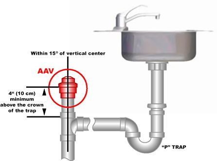

You should re-do it, obviously, and in the process add an AAV to meet code.
index.php
Something like this, but if you don't create a new hole from the basement, the two 45s are not going to work for you if the drain line comes up under the disposal. Instead you would use a medium 90 for the lower bend, and a long 90 to connect to the sanitary tee.

I'll post my mock up of what you recommended above, adapted for my house, later tonight. I appreciate the help. There's actually another 8" below the floor of the cabinet and a foot cavity behind the cabinet. The drain goes all the way out there, but it is sloped in the wrong direction.

This is what I came up with.
Im going to add some 1.5" to ensure 4" for the studor and to make it fit on the bottom and then tie the 2" into the existing drain (which is approx 6" below the cabinet floor and runs about 16"; I need to reslope it as its reversed, as in it slopes up towards the drain, so I'll slope it 1/8-1/4" per ft down). I chose to keep the clean out. Any feedback is welcomed. I'll post a pic when Im done.

Would what you propose clear the disposal? It looks like that cleanout would interfere with the trap arm. There are shorter cleanout plugs if it is close. Your general idea is good.
Instead of a the wye, how about a 45, and unscrew the AAV to use as a cleanout access. The AAV needs to be up at least 4 inches above the trap arm.
from https://terrylove.com/forums/index.php?threads/best-of-a-bad-s-trap-situation.84576/
Or if the two 45s don't fit, there would be two 90s as other choices.
Also, I am not sure the path from the santee down needs to be 2 inch or if 1.5 is enough.
The discharge tube does not have to come out at the angle it is shown, but maybe if the disposal is rotated a bit, things could work better.
