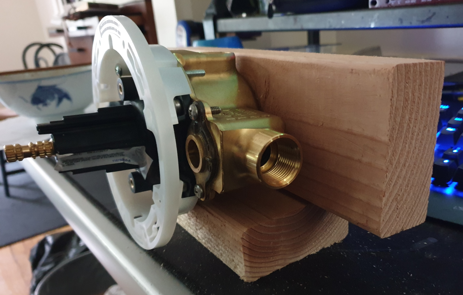

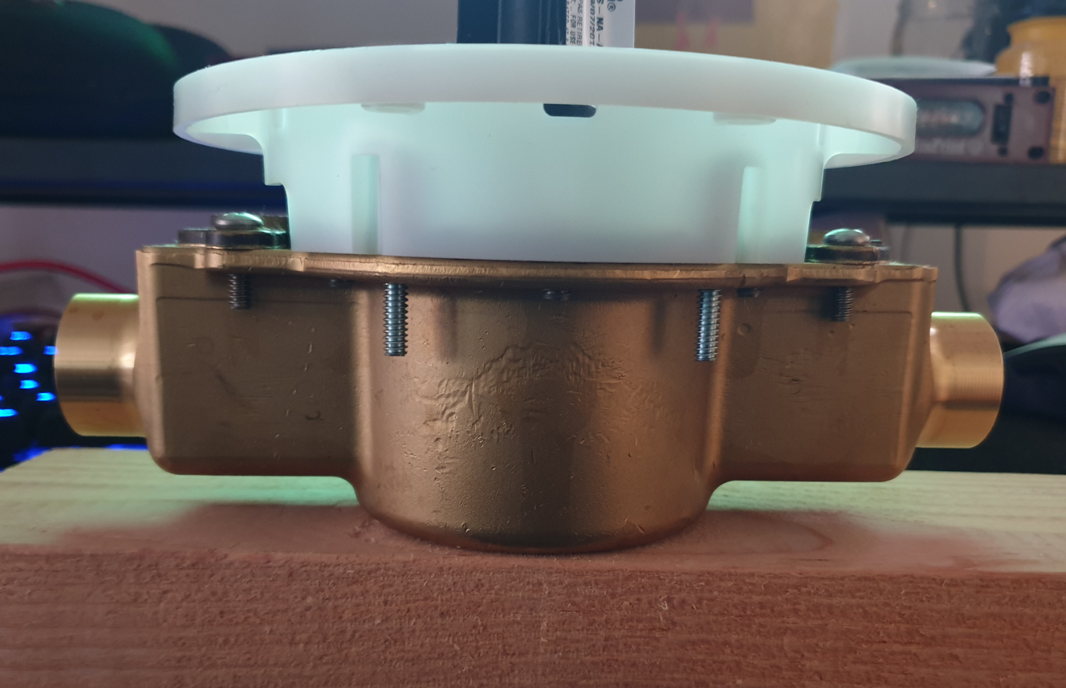

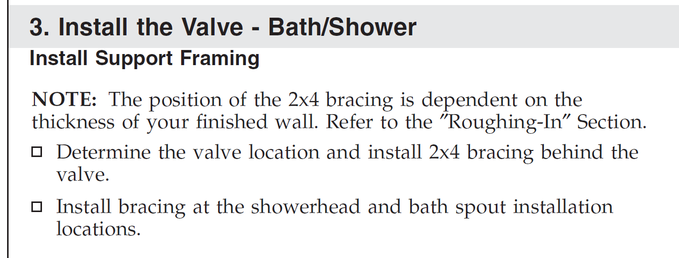

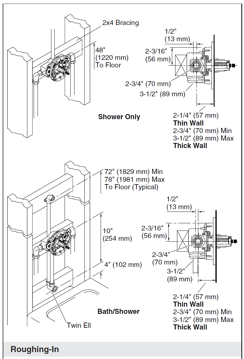

2. The 2971 mixing valve doesn't have any brass screw holes to secure it to the bracing. The only screw holes are in the plastic guard all the way in the front of the unit. That guard does seem pretty sturdy but the entire back of the unit is smooth and this is a heavy unit. It measures 3.5" from the front of the plastic guard to the rear of the unit and the guard is only 3/8" thick. Is this unit designed to be held in by the 3/4" copper piping? Since I'll be using 1" PEX which is quite stiff, I suppose it's some ok but I still don't like it. I don't understand why they didn't include some brass screw holes to secure the valve to the 2x4 bracing. In the below pic for shower only configuration (all the pics for all the configs look the same) you can clearly see the back of the unit up against the bracing. The rear face is just about 3.75" so even if I wanted to use those holes in the brace they don't line up.
This is the only part it talks about bracing in the installation manual.
If you go to the roughing-in section this is what you see. Not very helpful.

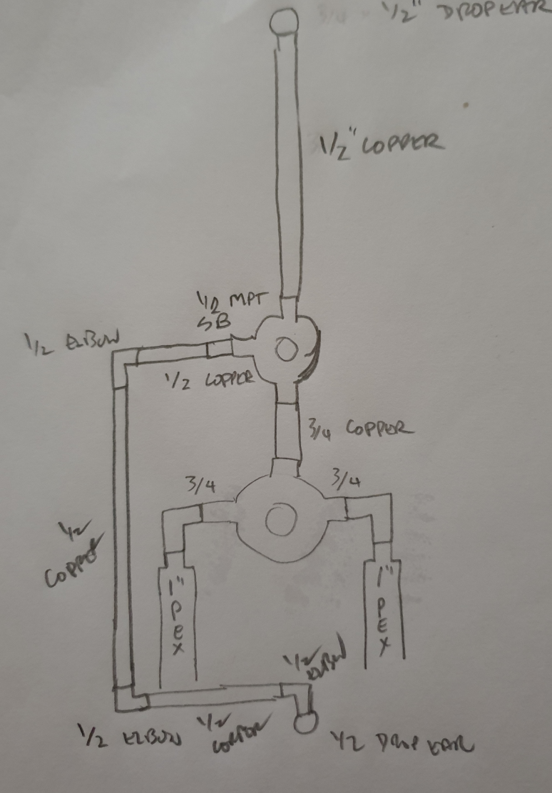

4. Here's a quick sketch of what I'm thinking of doing. Please feel free to correct anything.
5. Here's a pic of the unit sitting on a 2x4. I was thinking maybe I could use some straps around the outlet brass but those are inset from the back of the unit.

Maybe something like this?

I think you will fine using the 1/2" copper off the diverter for the tub spout. Similar to page six on their instructions.

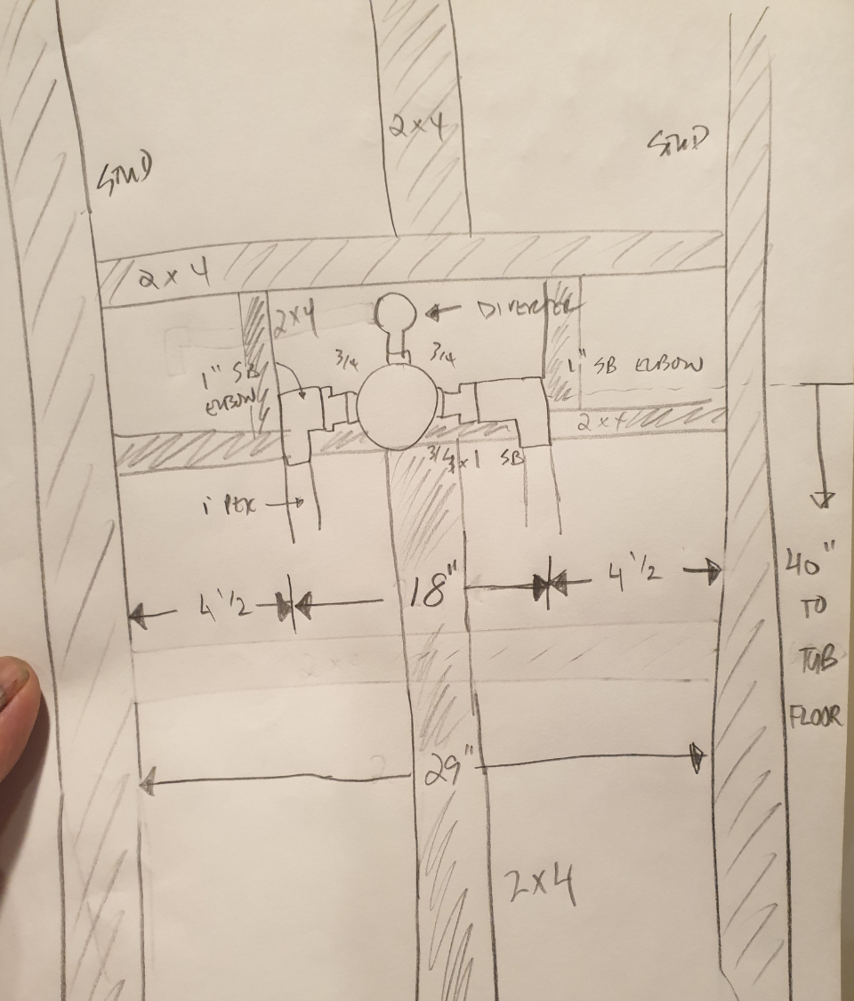

Here's a quick sketch of how I think I can mount the mixing valve.
Might not need the vertical 2x4 in between the horizontal 2x4 flanking the mixing valve.

1) The two elbows are fine from the diverter. The other option they showed without the diverter was for a diverter tub spout with a twin ell. You don't have that.
2) I normally run copper a short ways from a valve so that I can strap. I don't like using PEX for that. And I don't see a reason for the 1" PEX instead of the 3/4". Can't hurt I guess.
3) you can use 3/4" PEX to the shower head. What is the flow rate of the shower head? Normally 1/2" PEX is fine for that. Most of mine are run in copper if I'm hanging the valve from the top drop ear, but in a situation like yours, I often PEX it.
4) The drawing looks good.
5) Sure, that would work. They do make a copper plated plumbers strap.

4. I think I need to adjust the 2nd one. I think I'll go with #2 without the vertical supports. I'll install some vertical cleats using 2x4 or maybe 2x6 depending on how far back I have to install it which will make the horizontal braces sturdier and a tad easier to line up.
