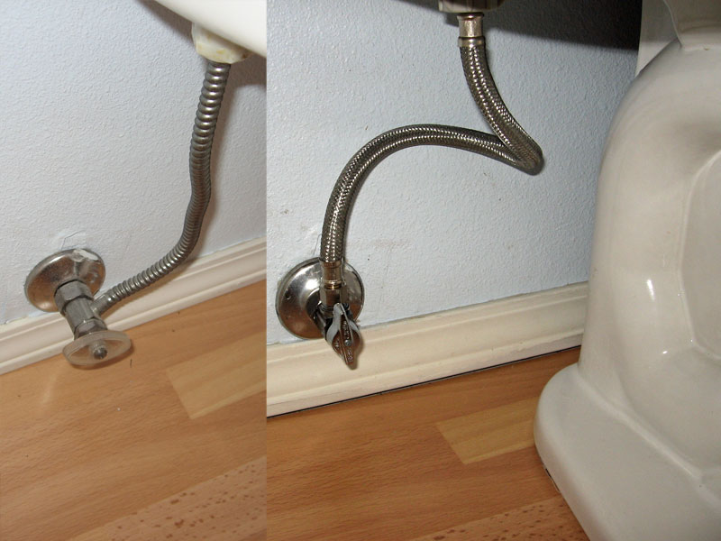

Underneath, the water hooks up to a 2 different toilet valves for the hot and cold water.

This is what is under my sink. The problem is that there is no way to disconnect the hose. The left valve is the one I have so I cannot replace the hose without replacing the entire valve, which I want to avoid if I can. Somehow the home manufacturer found some faucets that connect to the water the same way a toilet does.

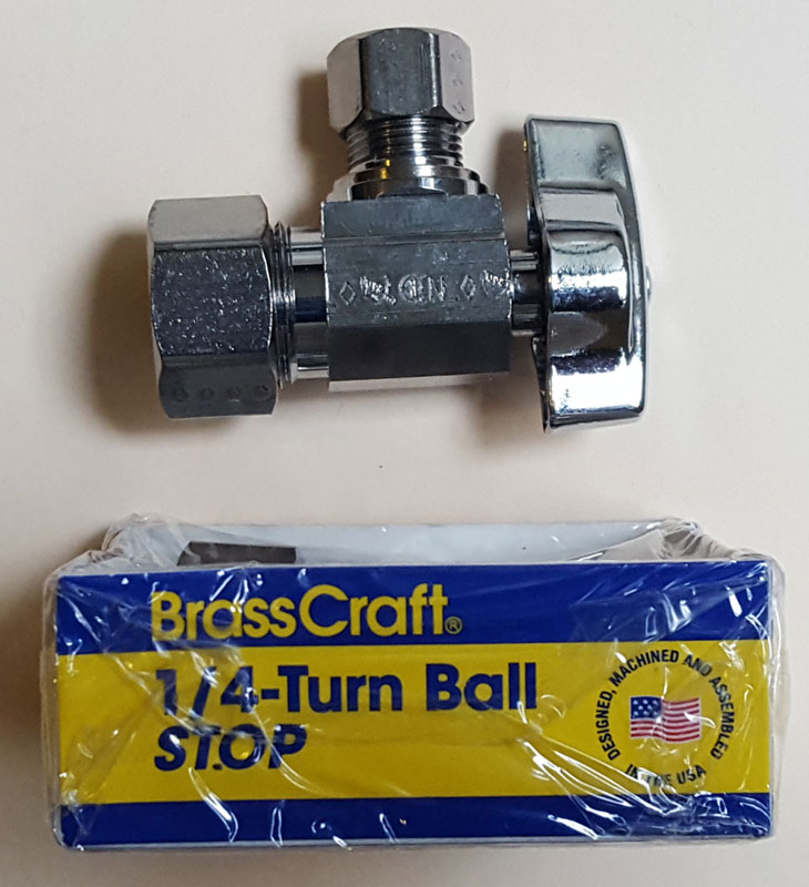

Got it. The lines under your sink have the supply line permanently connected to the valve. The other end of the supply line does not fit the new sink. I suspect that your flex lines under the sink are 1/2 inch nominal, which would be about 0.79 inch.
You did not post a photo of the your actual problem area(s).
If you had valves like in your picture, the one on the left looks like a compression valve. Replacing the valve should work. You might or might not need a ferrule puller depending on if the existing nuts fit your new valves.
3,473
The corrugated supplies in the picture work with either a 1/2" nut for lav faucets or a 7/8" nut for toilets. You also need the matching size rubber cone washers. The tubing and shutoff is the same for both size nuts. Plumbers refer to these shutoffs as one-time use shutoffs. The second time you bend them they can crack.
Now if the time to replace them especially since your new faucets require going to 3/8" compression.
