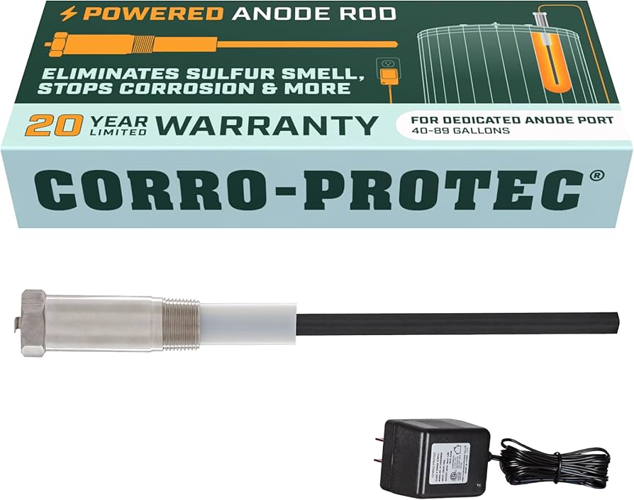

We are going to pull the anode rod as an access point to pour in bleach or hydrogen peroxide, drain out enough water to add the solution and let it sit for 24 hours. I do have some questions. You showed a pic of an electric anode rod; we don't have electric in the utility room where the WH is. Since the house is going to be sold in a few months we'd prefer not to run an outlet there. Is there some reason that the electric outlet would be superior in this situation? Would an anode rod wear out more quickly when hot water wasn't being used? This house is 3 years old. I just changed the one in our house serviced by the same water company at 5 years; it was pretty mottled up but not completely consumed. Thanks!
You will want to avoid a magnesium anode.
Some put in a brass plug instead of an anode, to not generate H2S. That should have a negative effect on the life of the WH.
So put in an "aluminum" rod, which is a combo of aluminum 90% and zinc 10%.
