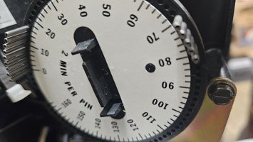

- Programmed for 18min in "Brine and Rinse" section starting at time 0 (programmed via pins)
An 18 minute Brine and Rinse cycle is unusually short. The B&R setting for a residential softener is typically 60-minutes, with the full approprate quantity of brine becoming transferred from the brine tank to the resin tank within the initial ~15-minutes, allowing the remaining ~45-minutes of slow rinse flow to continue to push the brine through the resin bed, and causing the released hardness minerals, iron, chloride and excess sodium to be eliminated to drain. Rapid Rinse then follows to recompact the resin bed prior to soft water flow to fixtures being restored.
When the Slow Rinse time is insufficient, the soft water supplied initially following each regen cycle will usually contain excessive sodium and the other elements that were not fully eliminated to drain. In addition, some amount of Iron Out or other acidic cleaner is more likely to remain present and detected at faucets.
I consistently went through about 500# Salt/year with 4 in the house, then 350# for the 2 of us, now more.
Although your demand meter initiated Econominder controller will continue to operate more efficiently than a Time Clock initiated controller, modern digital controllers allow additional programmability which may result in reduced water consumption and salt efficiency benefits.

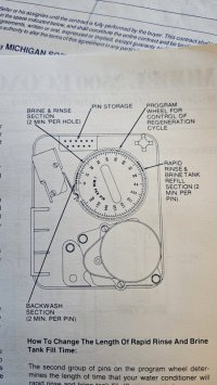

Wish I knew that many years ago. I double checked the manual and it says 2min/pin and I have 9 pins in the B&R. It also indicates about 18minutes on the label. I have attached a photo of the pins and the page of the manual.
However, I wonder if there is something "different" about this old system since the "Pin Storage" has a place for 11 pins and mine contains 7 unused pins right now. I might be stretching my assumptions but if I add the 5 + 4 pins in the manual's example program wheel plus 11 in the pin storage that's 20 total pins which matches what are in my system right now. It would take 30 pins to get 60min.
Awesome. That explains the smell when I "shock" it. I'm surprised we don't notice it under normal use with the Iron Out I have always layered in.
Your diagram sheet specifies the initial PINS (you have 9-pins inserted from 0 onward), control the length of the Backwash cycle. Your BW cycle is currently programmed for 18-minutes but a 10-minute Backwash (5-pins) is more common and usually sufficient unless there is excessive sediment or other visible debris that is entering from the well, which is not being fully rinsed away within a 10-minute BW cycle.
The instruction sheet then specifies the number of HOLES control the length of the Brine & Rinse cycle @ 2-minutes per hole. Your Program Wheel photo does not show the top of the dial, but from what I can see, it appears the B&R setting begins at 18-minutes (1st hole), and ends at 70-minutes (68-minutes = last hole), thereby making the B&R cycle 50-52-minutes duration.
Perhaps 50-52-minutes B&R has been sufficient if the brine was being fully transferred from the brine tank to the media tank in 13-minutes or less, but that will be conditional on the Salt setting and Gallons Capacity that is programmed in relation to the 'compensated' hardness level.
The 5-PINS you have inserted from 70 to 80-minutes, result in a 10-minute Rapid Rinse cycle if the controller is equipped with a 'Black' drive cam on the front (prt #17 on diagram on page 8 of the 2500 Econominder Manual). When equipped with a Black drive cam, there would need to be some number of HOLES after the pin at 80-minutes so as to program the Brine Fill duration @ 2-minutes per hole, followed by 2 PINS to end Brine Fill and also to signify the conclusion of the regeneration cycle.
If the drive cam is 'White', then the 5-PINS between 70-80 minutes, will result in both the Rapid Rinse and Brine Fill duration to be 10-minutes. The last 2-pins (@78 & 80 minutes) will signify the end of RR & BF, and also the conclusion of the regeneration cycle.
Depending on the gallons capacity programmed on the front program wheel, and also the brine tank refill flow rate (usually specified on a label located on the flow control fitting (prt #s 20 & 21 on diagram on page 15 of Manual)), will determine if a 10-minute Brine Refill was appropriate, or if alternate programming would have provided significantly higher efficiency and lower salt consumption.

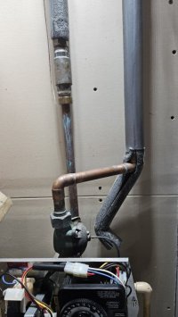

I've bought a new system and ready to install it.
When I removed the supply line insulation it revealed a check valve before the softener. Photos attached.
The new softener is taller so this valve will need to be moved higher up the copper supply line but I'm wondering if it's no longer needed with the newer system (Clack WS1). I've got room to move it but I'm getting mixed signals online for if it is a good or bad thing to have.
Appreciate any thoughts on this.
I think it was unneeded before, but the new valve probably counts turbine pulses whichever way the water flowed.
If you have a check valve, it is important to have a working thermal expansion tank for the water heater. Many of us don't have a thermal expansion tank, and rely on the big pressure tank to absorb any thermal expansion. The downside of that is the softener can measure "phantom flow". I figure it is small enough to let it happen.
So if no thermal expansion tank, use no check valve. To prevent measuring "phantom flow" have a thermal expansion tank and a check valve.

Thought I'd add that this appears to be for the softener and nothing else I'm guessing because it is installed after the 3 valve copper "bypass" plumbed at the ceiling.
After a little research it almost seems like it's a potential problem since the water heater does not have access to the well expansion tank if the water expands too much when heated. Although I havent noted any problems in 31 years...
It's in the way so I think I'll remove it unless you guys feel differently.
Thanks Reach4!
I was typing my last note before your reply came in so I'm sorry for the partial redundancy. Your explanation is much more thorough and proper. It does confirm my concern.
I'm removing the check valve.
