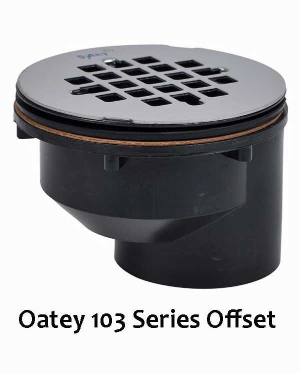

Thanks all, getting the shower soon so will be able to see in practice how it all fits out. I hear the points on the custom shower, the reality is that for cost/simplicity reasons with the curved shower model, is that it is much easier to use the prefab (outside of this drain issue). Right now, am leaning towards using an offset drain like this which should have enough space to get past the joist, with potentially just a bit of chiseling on part of the top of the joist: https://www.oatey.com/products/oatey103-series-offset-shower-drain-receptor-base-1301469814.
Ok well your good to go. you could notch the bottom of the studs where they meet the pan and shove it back a bit 1/2 inch or so easily . Id make a hole in cieling below and hook it up from below. Otherwise you have to set trap exact and the tail piece going up and then quickly glue it all up and throw pan in place.
Curious on this one, since I was thinking through this as well. What would prevent me from dry fitting to figure out the right rotation of the offset drain, and then cementing the bottom part of the drain to the tail piece in the right orientation before installing the pan + top of the drain that screws in? Seems like that could help prevent having to do everything perfect with setting the pan and glueing all at once.
usualy there is a big nut on bottom but this one screws in from top like a tub so your idea will work
