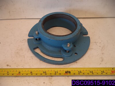

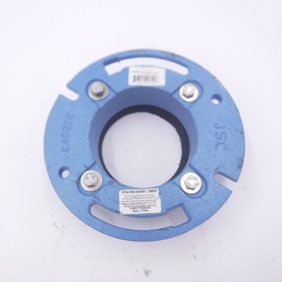

Consider an outside compression flange, such as "Code Blue". You will need to have sufficient clearance outside of the 3-inch pipe. When you glue, you need to get it right the first time. With compression, you get do-overs. How far above that subfloor will the finished floor be? You will want to know that and have your new flange available before cutting that PVC.
Plumbest C40-320 3inch pipe outside. 2 inch deep.
Jones Stephens C40320 3 pipe x 2 depth ***
I would tend toward this one:
One seller had one where the photo showed only 3 of the 4 bolts. I did not paste that link.
If you go that route, please post measurements. One thing I don't know is if the PVC pipe can extend above the black. That would make cutting the PVC pipe much less critical.
