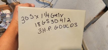

Ive got a problem with my well causing no pressure/flow in the house. I had the starter checked out with no issues so they told me its an issue at the well. One company said up to $15k and another said up to $10k. So I'm going to do it myself.
Current setup is a 325ft well, 249ft static, 3HP Goulds 18GS30412CL pump, 305ft of 1.25" galv drop pipe, pressure switch controlled on 45psi off 68psi, two 86 gal pressure tanks, house is about 150ft from well with flat level ground. Irrigation is tied in via a valve but I dont use it. Original 27 year old pump as far as I know. Well report attached below.

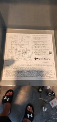

Thank you for the feedback on the pump. I'll admit I've had many conversations with Gemini about the pump size given variables in piep type, diameter, check valves, bladder tank size, house size, irrigation potential, depth, etc but in the end I wasnt satisfied and figured if I stick with 3HP, I at lesst know what to expect with water delivery and we have been happy with it thus far. The two well repair companies I spoke with told me if I didnt have any complaints then they'd stick with the size I have too. So I did put some thought into it but I should have done more and check here to confirm before ordering. At this point ive got the 3hp on its way across the country though.
Regarding the testing, this is what I did that led the well repairs guys to point at the pump/piping
Symptoms: Pump starter is humming and its really really slow to build pressure. Run capacitor was really warm and the relay was warm. Was able to build 48psi max after a while of running (that was for like 3 days after this started. After 3 days and still today it builds like 5psi) and the pressure holds after the pump turns off.
Troubleshooting:
Replaced run capacitor, replaced start capacitor, replaced relay.
Testing: Measured resistance crossed overloads and got zero ohms. Measured resistance across contactor when manually pushing it in and got zero ohms L1 to T1 and L2 to T2. Disconnected wires and Measured contactor coil resistance and got 1.056k ohms. Measured current on red start wire and got 6.8A. Measured current on yellow and black wires and got around 16A each. Measured voltage between yellow and black and got ~240V, red and black ~330V, cant remember yellow to red. Disconnected yellow red and black wires and Measured resistance yellow to black and got 2 ohms, black to red was 6.8 ohms, yellow to red was 5.3 ohms.

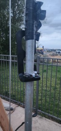

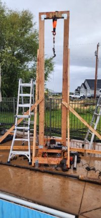

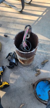

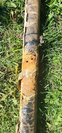

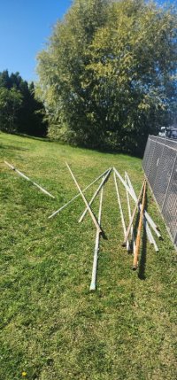

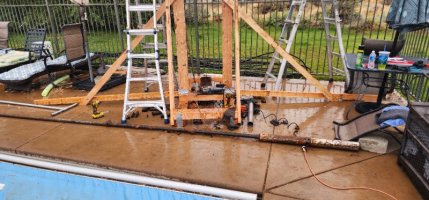

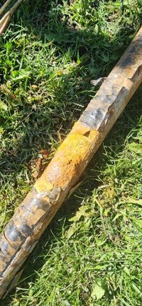

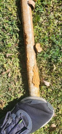

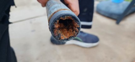

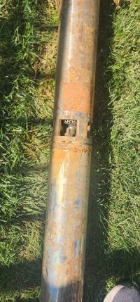

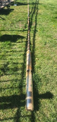

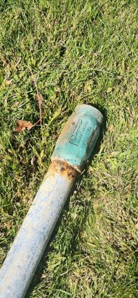

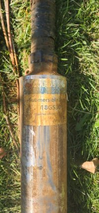

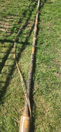

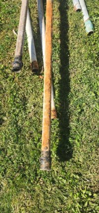

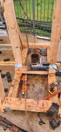

I did end up swapping the pump out. The galvanized pipe had rusted holes in the bottom stick. It took about 3 hours to assemble my extractor and then probably 4 hours to get all 14 and a half sticks of galvanized pipe out.
I got to go visit family an hour away and they had a supply shop that carried 1.5" pvc so I was able to get it.
I feel like a real chump for asking questions and not following the guidance here, but I chickened out. The place I got the supplies from does well pump installations as well and them plus the 2 people I got quote from told me they'd put in 3 check valves since its 300ft deep. Maybe they just like selling parts or they like doing services after the systems fail early because of the parts they install, but I ended up having to their advice. I wasnt planning on using the torque arrestor or any dope on the threaded pvc connections based on what ive found on these forms but man they again convinced me that tight connections with the dope they sold wont come undone. So I followed them there as well.

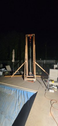

Before the install i dropped a bobber, weight and sting down to check the static level and it was ~216ft, which lines up with my neighbors well seeing 222ft static 5 years ago.
I thought the install was gonna be faster than the removal but that didnt pan out. It was probably 6 hours to install the 15 sticks including the splice and taping the crap outta the wiring guards on the first stick. The wiring was single conductor #8AWG wire and it was sleeved in 3/4" poly tube the entire run so that was pretty cool. I also ran a 1/8" stainless safety wire attached to the pump. . I tested the fist stick in the pool before dropping it into the well and then on the last stick I ran it and flushed it out OK the ground before dropping the pitless back on. It was a long day but at about 9pm I was able to slip the pitless on and get water back in the house. I think it was 10 days of not having running water in the house haha. RV trailer kept us shower with water from my friends house.
~$2k for the piping and associated materials
$2k for the pump shipped
$2k Rounding up on other tools, winch, brackets and wood (orange pipe clamp tool was $450 with 2 day shipping).
So for less than $6k I was able to do it myself with friends. Didnt get new wire but mine was in great shape given the poly encasement. Pretty good compared to $10k and $15k estimates i was given. In hindsight I agree with you guys I could have went with a smaller pump and saved probably $2k.

Im curious why it seems odd to you just for my own education. I have no experience dealing with this stuff so im just genuinely curious.
More pictures of the pipe I pulled out. I attached those two exhaust clamps in the middle of the pipe since my tower wasnt tall enough to pull up coupler to coupler. There was also some electrical tape on the inlet to the pump that im sure wasnt helping it out. They put tape over the couplers that were deeper which made it a little harder to grab with the pipe wrenchs but im guessing that was to help prevent them from coming loose. I didnt do that on my new pipe.

That is a monster pump that I have seen used in commercial applications. The wells were near farm operations, aerial applicators and oilfield locations and never near a swimming pool. In my area that well would have a galvanized steel pressure tank 10' tall and 500 gallons in size.
Amazing job! Thanks for the pictures. A smaller pump would not cycle as much, but the two huge pressure tanks will help. A Cycle Stop Valve would make it even better. The three check valves will most likely cause water hammer problems, but usually not when they are new. Plastic pipe will have some torque to it compared to the galvanized, so I hope it doesn't chaff the single conductor wire against the poly covering. Torque arrestors don't help, get stiff over time, and make it hard to pull the pump. Wiring guards can also be a problem. Too much tape on things can also be a problem. If that 1/8" SS cable comes loose, it will act like a wedge and keep the pump from ever being pulled again. But you did good and probably better than what you would have gotten if you had it done and paid top dollar.

I did look at that cycle valve for a little bit since I seen you mentioned it before. Like you said about the two tanks, gemini suggested those should help and I was ready to be done with the project haha but that might be on my next list of to-do.
The wiring was submersible rated so hopefully it holds up. The bottom section that I could see looked good as did the top that wasnt under water but I did forget to megger it.
The torque arrestor kept me up for a few nights going back and forth on it. Hopefully I dont have to touch it for another 25 years but if that time comes maybe ill be more financially stable (doubt it lol) and just pay someone to deal with it.
Working with the safety wire was interesting. I'm not happy with how ive got it attached at the top so I ordered on of these well rope hangers. Ill see how i like that.

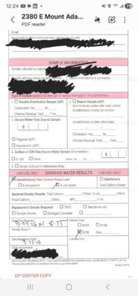

I went and got a water test and they detected coliform but no e coli so now I gotta sanitizer it. So back to the RV again for 24hrs while the bleach sits in the system.

If you are looking for a negative coliform test, you have to use care in sampling, including heat or disinfectant at the faucet to kill bacteria where you take the sample. Search for sampling procedures.
