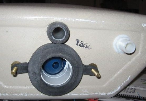

I would like to write the final chapter on the Vacuity. About 5 - 6 years ago our hotel chain needed to choose a new 'standard' toilet for our room replacements. Based on the data at the time, we chose the Briggs Vacuity. It worked really well, despite the occasional plug that was tough to remedy due to the design. However, over time we have come to learn that several manufacturing 'defects' have started to become more pronounced and common, causing this toilet to become unreliable.
 What we have found is that some new units work really well while other do not work at all, or rather, work for a few weeks then need constant attention. We have pulled a few of the 'problem units' and cut them in half (with a diamond saw) - see enquiring minds.,jpg - to see if we could tell what the problem is.
 There are actually three problems that can occur during manufacturing.
1) There is the trapway slump which has been mentioned here.
2) There is also an the trapway slump around the inside edge of the outlet of the trapway that can be as much as 1/4" to 1/2" wide - forming a 'shelf' that hangs up material.
3) The single worst problem though comes from a ceramic 'plug' that is cast into the bottom of the trapway bend (at the back of the trap) during mfg. This plug (in some units) has a tip the sticks up into the trapway 1/2" or MORE where toilet paper hangs up and builds up at the back of your (slumping flat) trapway. (The picture shown has only a small plug, but this unit had a flat trapway and a very bad drian lip so it had to be pulled)
So, each defect isn't a big deal by itself, but if your model has any two of the issues it will cause you periodic plugs, and if it has all three it will be a constant source of trouble and will need to be replaced. In the Vacuity's defense, it was the only toilet (at the time) that flushed washcloths, shampoo bottles and mini bars of soap. Which are a constant problem for hotels. So we are in the process of switching brands now and testing the Toto Drake as our likely replacement. And I now look forward to 'torturing' the Toto.
