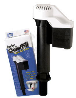

 : When a new flapper or new toilet seat or other such part is needed, can Totos or American Standards take these? Or do they require specially made parts? Donna, both American Standard and Toto use the standard round front and elongated seats. Fill valves can be had for both also. American Standard has many that may be a factory order, but most of their models can use off the shelf fill valves. Toto's with the 2" flush valve use standard parts, the 3" flush valve models use their own flapper which can be ordered and a Korky fill valve made by Lavelle.
