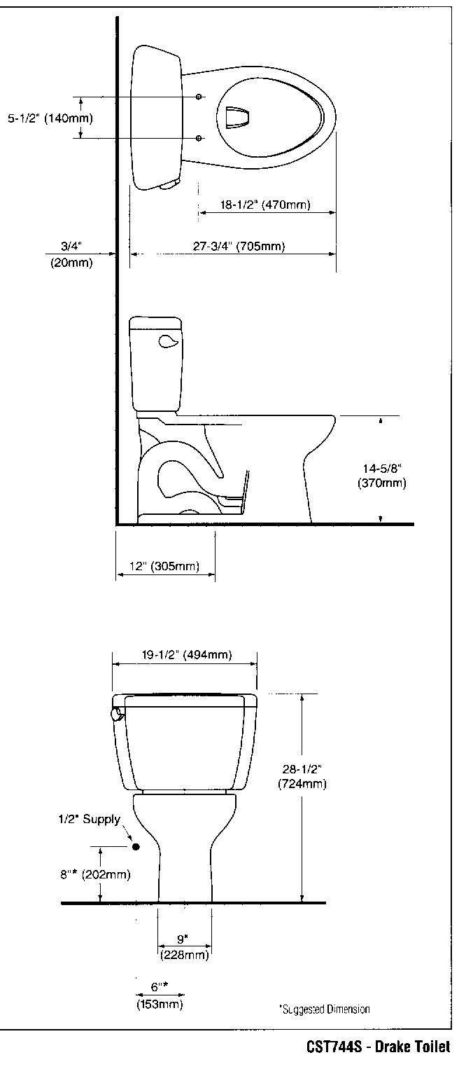

| Posted by terry@terrylove.com on February 06, 1999 at 15:42:05: | |
| In response to Re: Toilet rough-in measurement | |
![]() 12" from the finished wall, to the center of the drain. 15" from the side to center. Terry : What is the rough-in measurement from the wall to the drain? Is the measurement from the wall to the edge of the drain or to the center of the drain. Thanks for any help. |
