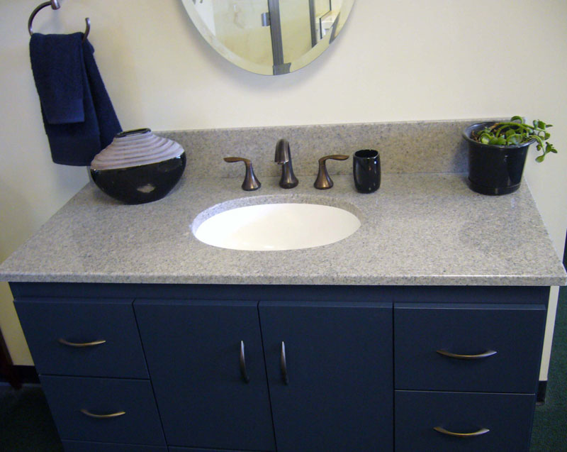

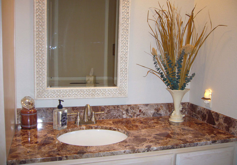

Below are some cultured marble products from Designers Marble in Woodinville WA
