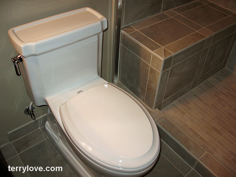

Toto Soiree
I'm selling the Soiree for $595 in White and the Guinevere for $649

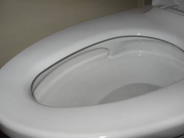

Cyclone Flush System
They both use the double cyclone flush, that sweeps water around the bowl to keep it clean.
The water speeds up as it gets farther down the bowl.
Combined with the Sanagloss finish, it's an improvement over what we have come to expect.
The parts in the tank, are similar to other Toto toilets, so repairs will be easy if needed.
So far, other models like this have had a very good track rating.
Performance seems to be similar to the Toto Ultramax, they both have the large 3" flush valve and siphon jet.
The main difference is how they rinse the bowl.
The Ultramax rinses straight down the bowl, the Soiree and Guinevere have the Cyclone rinse that races around the bowl.
One customer in Spokane said it reminded him of his Ford Cobra.
Quote:
These are the best Gravity toilets that Toto sells.
The people that own them, tell me they love them.
If you want all the features in one toilet, this is it.

Between the two?
Go with the Soiree or the Guinevere.
The Double Cyclone rinse works real well.
The bowl covers more footprint too. The photo above shows that it covered the old toilet outline that had been pressed onto the wood floor.

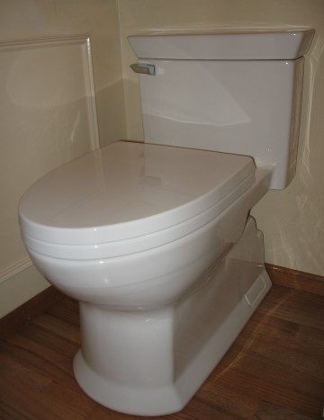

Side view of the Guinevere toilet by Toto.
It comes with a nice slow closing seat.
Installation instructions for the Soiree and the Guinevere

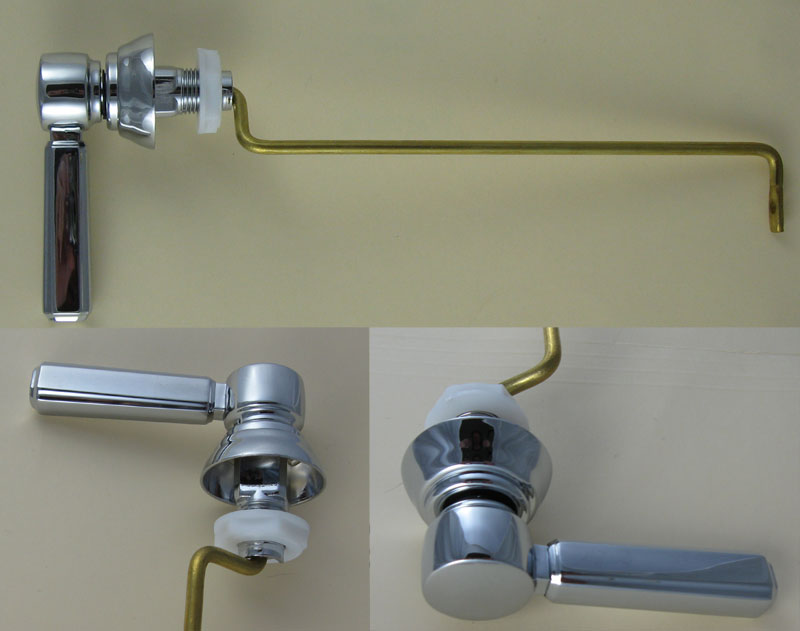

Default Thu213-cp
The handle for the Guinevere
Pretty nice.
