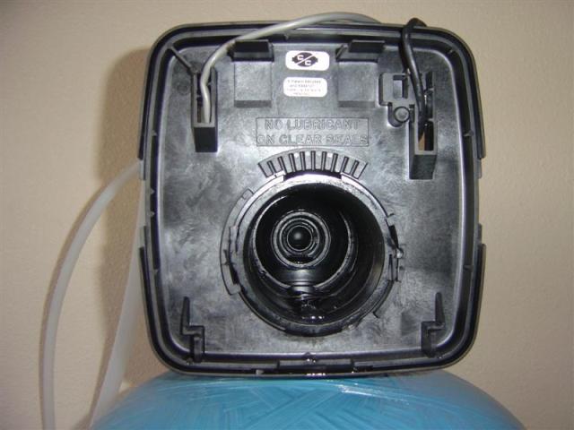

Andy and Gary: I want to see if I understand the issue about lubricating o rings on softeners.
Gary said silicone lubricant isn't required with a silicone o ring. Andy said it is ok to use silicone lubricant on o rings. I don't see a direct conflict between those statements--rather a different emphasis.
I know that Gary is a proponent of Clack valves so I looked at the documentation for Clack WS=1 valves to see what is said about o ring lubricants. I found the following statement in more than one place: "Do not use Vaseline, oils, or other unacceptable lubricants on o-rings. A silicone lubricant may be used on black o-rings." I found no reference to using water as a lubricant in the Clack manuals I reviewed.
So my take is that it is ok to use silicone lubricant but sometimes it may not be required. I guess the practical question that remains for me is how do I know if the o ring is a silicone o ring that doesn't require silicone lub?
The only lubricant required on most o-rings used on control valves etc. today is water.
Gary, a more approprate statement from you would have been something like:
"Some people use silicone on their orings, which is fine, but I have always used water and it works for me."
and again my o-rings aren't made of silicone!
Until they rewrite my Kinetico manual I will continue to use silicone as it recommends. It makes assembly much easier. Thanks Chuck
Tip: For those of you wishing to use silicone lube/sealer for any purpose, Lowes sells a reasonably sized, reasonably priced ($4+/-) container. Say, for the o-rings on a kitchen faucet spout.
Silicone o-rings do not need lubrication but if you want to lubricate, water works very well.
Clack also says to not lubricate the seals. They are silicone.
http://lib.store.yahoo.net/lib/newater/WS1INS.pdf
I did find these fairly clear and specific instructions on Clack valves. I guess I was going on this.
Andy, The link you provide is to a document prepared by the online seller of softeners--It is not, as best I can tell, a Clack document.
The quote I provided in my post above was taken from a document on the Clack website--specifically this document at page 35:
http://www.clackcorp.com/valve/Manuals/V3115-99_WS1_1.25_Drawings_and_Service_Manual.pdf
I read every word in that competitor's installation guide that Andy posted.
There are many errors and omissions in it. Some errors are really bad!
I could copy/paste them but since they are a competitor, I won't. I'll just feel bad for their Clack WS-1 customers.
They have revised a guide used for Fleck to fit the Clack WS-1. The fit isn't very good.
I don't know fer sure but, IIRC, silicone and sch 80 pvc may not mix well, yet they are telling their customer to use silicone with sch 80 PVC. I do know there is no need for lubricant on the o-rings on the plumbing connectors.
Anyway, silicone o-rings do not need any lubricant but water works very well.
