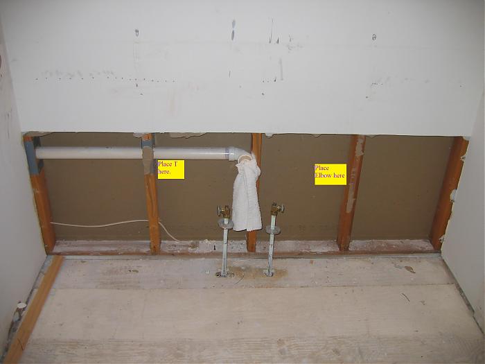

Hi all. Hope someone can help me with this bathroom remodel.
- Converting a single vanity to a double vanity.
- The problem is that the new vanity has drawers in the middle (between both sinks) and cannot connect two "P traps" underneath.
- So looks like I need to change the plumbing in the wall. A pic of the existing pluming is attached.
- I was thinking about doing the following:
- Putting in a T to the left of the existing drain
- Cutting pipe and inserting 1 1/2 pvc to the right of the T
- And then putting in an elbow to the right of the existing drain.
- This would then give me two drains to connect two "P traps" to.
- Existing drain would obviously be eliminated by putting in the T, the 1 1/2" pipe and new elbow.
So will with work? Or are there other considerations and/or concerns? Any help would be greatly appreciated.

That will work. Put a san tee at first connection and a 90 at your second connection. You should try to have the water line's piped to the proper location also.
NO.
You cannot inline traps.
Find your center of the double bowl vanity, use a cross-tee with a vent going up the center and back towards the vent stack.
You already have a trap arm that's too long for most standards by code. 3' 6" I believe is max on 1.5".

NO CODE allows a five foot 1 1/2" arm. And you cannot install the tee that way on any arm, much less a 1 1/2" one. The water flowing past the tee can create a venturi effect and compromise the trap seal. As a practical matter, there is almost no way to do what you want to with that drain and do it legally or properly.

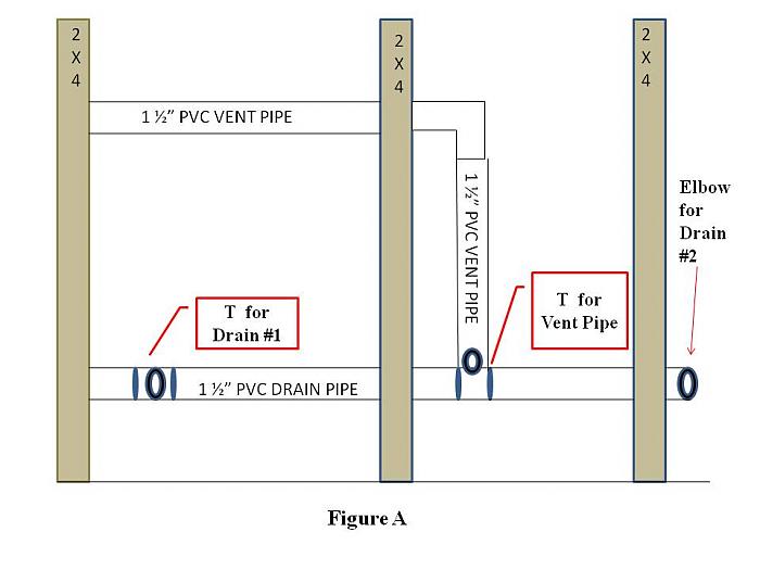

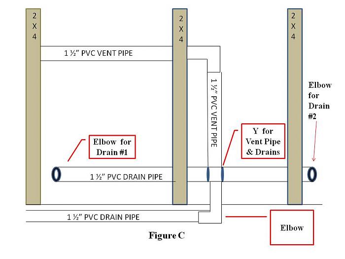

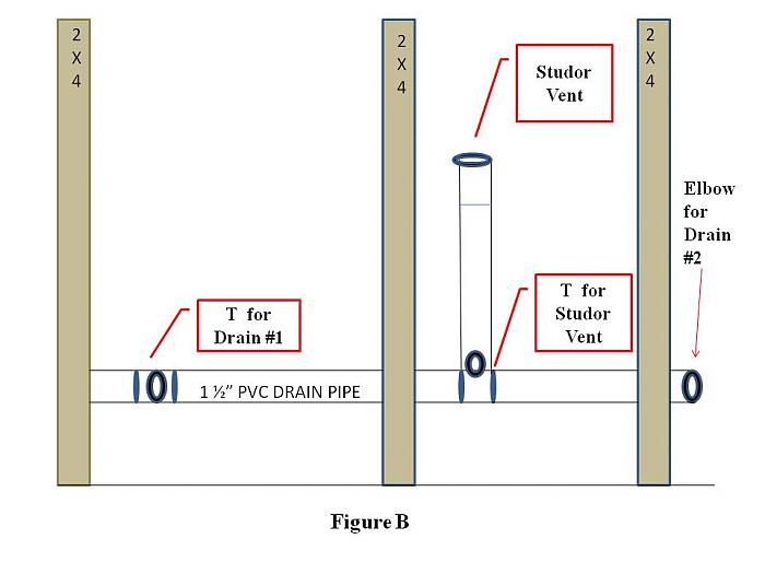

Ok. Forget about the picture I posted which shows what this currently looks like. I am attaching 3 figures of some scenarios. Let me know what you think. I think Figure A is what you were getting at. Figure B was just a thought and Figure C I'm thinking is last resort.

Figure C with a double fixture fitting would be correct.
A cleanout above the double fixture fitting would be good also.

C is the correct one using the proper fittings. One problem is that your existing drain arm is too high to do it that way, which is why I said there is no way to do it properly given your configuration. figures A & B both still have the right hand sink flowing past an unvented left hand drain.

Would figure A work? Probably, the chances of a venuturi effect emptying the left trap are small, esp. with the vent in the right spot now. But, code is code.

You did not read the code right if at all. 82.31(11)(b) Common vent's for horizontal drains. It's the same as the first fitting downstream of fixture can be a short sweep.If you have a single lav and is on a arm that first 90 is short sweep. First fitting only! If you have a double lav hotizontal common vent the same rule's apply for second sink tie in. How could the drain from one sink empty another on a lav, it's not located at a base of a stack where something like that is more likely to happen. The water running thru drain is not that strong to even cause such effect. Look closer before you try calling me out.

I agree - venturi effect as mentioned above is not likely to happen - esp. with the vent added to prevent vacuum pulling water out of left trap.
Update - checked code quick, and it does appear that you are right, however 82.31(11)(b) also states that the vent shall be located downstream from BOTH fixtures. So, none of the above illustrations are legal in WI. But, it does appear that you can use the san-tee on it's side to connect the downstream lav to the horizontal branch.

Figure C is the one that NPC allows for your application.
If you went with your first drawing, "worst case scenario" if you filled sink #2 and dumped it, it would suck trap #1 dry allowing sewer gases to escape. Prime example; Men shaving, women cleaning hair brushes or undergarments, bikinis.
