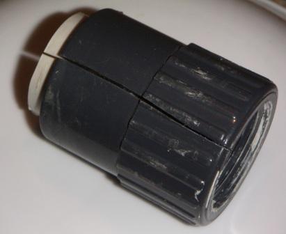

Screwing ANYTHING into a female PVC connection will expand it. The tighter the connection is made the more expansion that will occur. Eventurally the female connection will split. And any corrosion in the joint because of miniscule leakage will also overstress the female connection. Use a brass coupling or something similar to join a male metal connection to a male PVC adapter. And adding additional layers of Teflon tape only makes the problem worse.

HJ is (as usual) correct. Here's a female PVC fitting (that had a male PVC fitting screwed into it) from my professionally-installed water softener that failed after a couple of years. The installer mentioned (as he was using his 18" wrenches on the fittings) that he never had a leak. Note that when the fitting failed, it took the pipe with it:
I always use Teflon tape plus some really gross blue thread sealant that winds up getting all over everything and tighten only to one oomph.

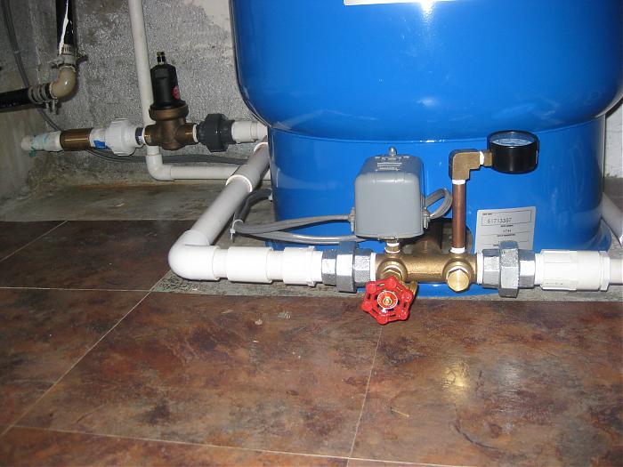

I used galvanized unions only on the tank T since the PVC ones wouldn't seal(and sounds like it's not recommeded), the rest is PVC. The well is only for outside watering. We have city water for the house.
Hope the way I plumbed it will be o.k.?

Nice looking job, but that check valve that is in line just before the pipe goes through the wall should be removed.
bob...
estone
72
Colorado
Speedbump, just want to clarify, and I'm sure you know, but that is the line coming in from the well. I Thought you needed a check valve so that water won't go back toward the pump?

All submersible pumps have a check valve in or on their outlet, and that is the only one that is needed.
Just suggestions for next time....
I wouldn't have used unions or galvanized anything anywhere. Rarely does another part match up identically when you have to replace something, and PVC is easily cut and put back together with a coupler.
I would not lay the gauge on its back, it can cause dirt build up over time. I would have screwed it into the the tank tee. Right now air is trapped in the elbow, which much less would be if the gauge was in the tee.
I would have used the 3-4" brass nipple for the switch, that allows the clearance needed for the gauge under the switch.
I wouldn't have used the brass nipples on the water line, I would have run PVC to and from the tank tee and the line coming in from the well, with as few fittings as possible.
