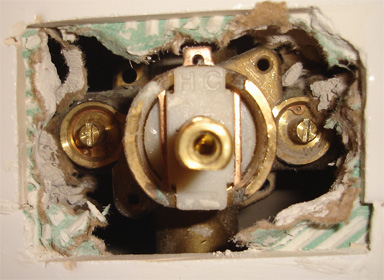

ok I got the faucet off ok and behind the part you turn there are two little knobs you can turn with a flathead screwdriver. Should I mess with those? Maybe they are closed? There seemed to be a lot of drywall over one of these. I'm assuming they are hot and cold valves or something. What do I do??!!?!

They are built in shut off's for the shower valve. I'm thinking that whom ever installed the shower valve did not set the high limit for the valve. If the high limit is set to high on delta valves when you turn it all the way on the pressure will drop almost like if you went to far and your starting to close it again.
I would adjust that and i think this will solve your problem.

Thanks, I turned the right one and it turned the cold water off. When I turn the shower handle to hot, nothing comes out even when I turn the one on the left which I assume is for the hot water. The sink and everywhere else gets hot water. Should I open up the valve on the left that must control the hot water and try to clean it? There is hardly any room to do anything in there without breaking the tile.
That water running like I said above is only once in a while, may be my neighbors or something also, not sure. Its a townhouse.

Here is a pic of what I'm talking about, see attached

It is a pressure balance valve. You should have no water coming out if you turn the water off on either side it is a safety feature.
just make sure the hot is open all the way or if you are thinking of opening the wall make sure the water is off all the way hot and cold

Do not open the valve unless you know the house main is off. On the new style single handle shower valves if you turn off one side and not the other the water will not come out no mater how much you turn the shower valve. It can fool you and is very dangerous. So to play it safe turn off the house main
All shut off valve are righty tighty lefty loosy.

The first thing is to make sure both hot and cold shut offs are on. The next thing to do is take the valve apart to see if something is blocking the flow. there really is not much to do about this unless you find that some valve (shut off) is not open all the way. Taking apart a shower valve can be very easy or very hard. Some valves can be fixed by replacing one piece some many pieces. Can you tell what brand the valve is. Sometimes the manufacture will send you new parts free.

I'm not really sure where to go from here to take the valve apart. I'm sure you guys would know what to do... What should I try to do? Snap off that HC white piece of plastic or what? I have no idea what to do with this
