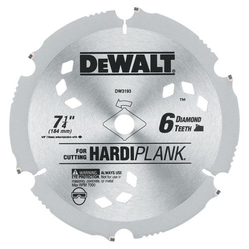

I've had good luck using the 7-1/4" Hardiplank carbide saw blades in my circular saw on cement board. Yes you can use a regular carbide blade, but it is extremely dusty and the blade wears out fast. The hardiplank blades last alot longer and cause less dust. I've seen the Hitachi brand hardiplank blades in 10" and 12" but I've never cut any cement board on the table saw. Be sure to take proper safety precautions while cutting cement materials.
