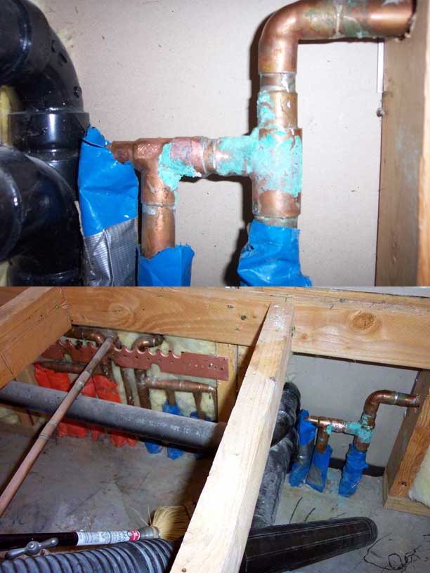

Aramaflex would definitely help with many problems of direct burial in soil, looking at the photo of 1" main coming up threw the slab is all corroded around the joints I was thinking FLUX I could be wrong though, cutting out the pipe section below the manifold found to be corroded inside.
I wish I knew what caused this! all other pipes & joints look healthy but may be corroded inside them as well and haven't leaked yet.
Did I mention my life suks.

your life sucks worse than you realize
that is not armaflex coating those pipes
comming out of the floor in your pictures
...that is plain old cheap duct tape
and we have run into many situations where that stufff dont hold up
very long at all .... we have reapired many of those leaking at the tape...
they use it to come up through the floor but their is nothing in the gravel..
what might be causeing this is aomething like an
electrallisys action with the outgoing main line...
it dont look that bad...
